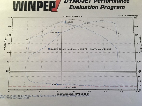

so that I wouldn't have to pay twice for block machining..... once for that 0.010 "cleanup" cut, and again for the final shave.
and you don't want to pay twice for block decking,, I had mentioned in my earlier post to:
1) get all of the hot tank work done
2) do what ever block work that you want done, including a clean up cut on the block, just to give you a nice clean sealing surface for the head gasket
3) Install the crank and a one of the pistons that you will use and on the rod that you will use to get the final piston recession number
4) have the valve work done on the head, using the valves that you plan to use cc the head and get the head combustion chamber volume
5) using an on line calculator and using the actual piston recession value and the combustion chamber volume, calculate out what you will need to have trimmed on the head
to get to your target static compression ratio.
The block and head deck surfaces are only cut once. And I would use the pistons that you plan to run in the actual block to get the piston recession number. Some after market over sized stock style pistons have a reduced compression ratio to make up for the additional volume gained with the larger OD. Crazy but true.
The engine in the 83 D150 is .030 over stock style Silvolite pistons, 8.5 static compression ratio, Holley 2280 2 bbl with water heat to the carb base and cold air induction, dual Dutras with 31 inch long extensions on them prior to joining in a Y, HEI ignition,
The cam is Oregon hydraulic 1333 intake on the intake side and Oregon Hydraulic 1527 intake on the exhaust side
212 Intake at .050
206 Exhaust at .050
.447 Intake lift at the valve
.432 Exhaust lift at the valve
on a 105 Lobe Separation Angle
a hydraulic cam similar to the mechanical Oregon 819 cam mentioned earlier
the 819 is
212 and 212 at .050
.448 lift at the valves
I had the D150 on a chassis dyno, a chart is shown below
133.7 HP at the wheel at 4000 RPM
210.2 Torque at the wheel at 2600 RPM
when accelerating you can feel the torque come on about 2200 rpm and the curve is fairly flat from 2500 to 2800 RPM that puts the good part of the torque curve
right in the range of highway driving RPM's I have 3:73 rear gears.
For the exhaust tone, I was particular on the exhaust routing, it exits on the side of the truck in front of the rear wheel.
I have had the D150 on the scale at the local metal recycle yard,, it weighs 4100 lb with 9 gallons of gas in the tank and without me in it.
Note: I had previously written 3700 lb as the weight in this posting, this morning, I went into the garage and pulled the note book where I write these things down and in June of 2018 I had recorded 4100 LB as the weight.
File comment: Exhaust routing
File comment: Chassis Dyno, power at the rear wheels
PostPosted: Mon Apr 20, 2020 7:39 pm
Posts: 3286
~134HP (I rounded it off) at the wheels, what would you guess at the flywheel? 180? 200?
PostPosted: Mon Apr 20, 2020 8:24 pm
Posts: 14950
165ish. Drivetrain eats 15-18%.
