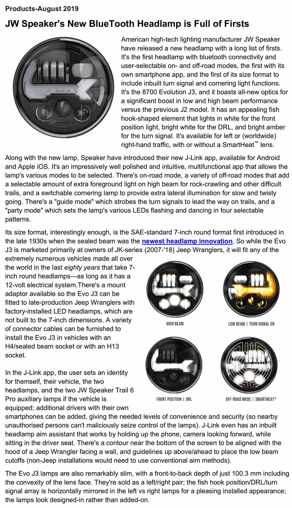

That depends which 7" LED lamps we're talking about, and which buckets. JW Speaker makes multiple different 7" round units. Their top-of-the-line item is fun: almost Star Trek-level lighting technology in the world's oldest headlamp format (standardised in 1939). DrivingVisionNews writeup of that lamp is attached to this post. Thousand bucks a pair. Down from there is a variety of versions of their Evolution-2 headlamp (heated or non, black or chrome, with or without built-in daytime running light). Every time they revise that lamp, it gets more compact at the rear. And they've got an extra-shallow 7" round lamp (this one) for difficult-to-fit buckets.

Great to know about the shallower lamps. I do not see prices online for those yet, but will look into them when I get to reassembling the 64 Dart.
I bought the 8700 J2 and had to cut quite a bit of the bucket out. I just finished installing one this morning on Project V (66 Valiant with 63-65 Dart nose) with new adjuster hardware from Vans Auto and that works fine.
Why do you need 4 headlamps for the 5.75"X4 system if the JWs will do high/low beam in one lamp? I was just going to run a pair in the outer position and omit the inner pair. I assume that provides sufficient light, and then I can just put aluminum plates or something over the inner buckets. I see in the JW spec sheet for the 8631's that the lumen output is about 15-20% lower than the 8700 J2 7" lamps, but I would guess that is still enough??
