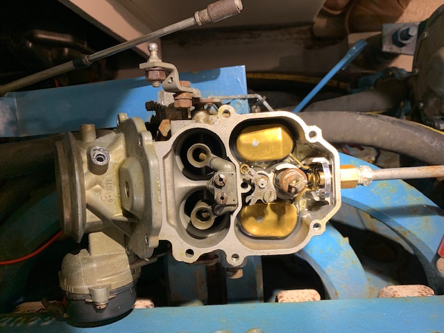

I checked the function of the accelerator pump. No stream, so I the top off the carb and operate the pump by hand and fuel seems to squirt around the pump cup/ seal back into the bowl. I'll be looking for a rebuild kit.

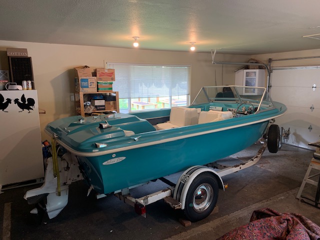

I've put some pics of the boat, engine and carb so you guys can see what you are helping fix and to assit in more expert identification of the carb.

Carter BBD. If the leather on the accelerator pump cup is in fair shape you can soak it in light oil so that it softens and swells enough to conform to the pump bore. Also, there needs to be a check ball in there so that fuel isn't pushed back out the pump inlet. This works like a squirt gun. There has to be a check valve between the reservoir and the pump so that the discharge goes to the nozzle.

Yep, BBD. Hope the accel pump and rebuild works well. Pretty boat!!
