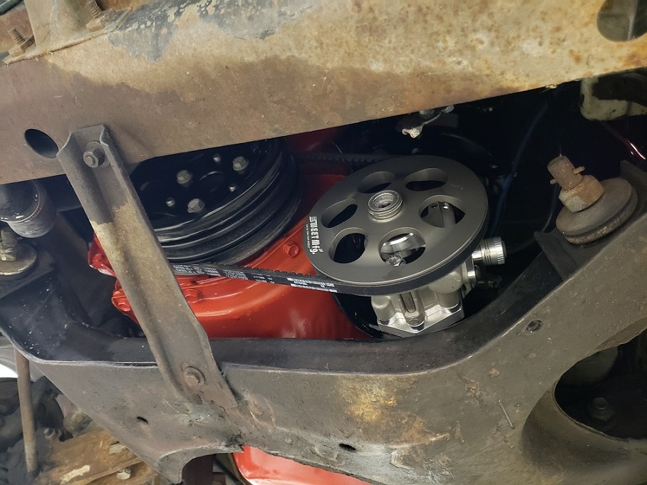

PostPosted: Fri May 15, 2020 5:32 am
The pump I use on the clutchflite would work.
