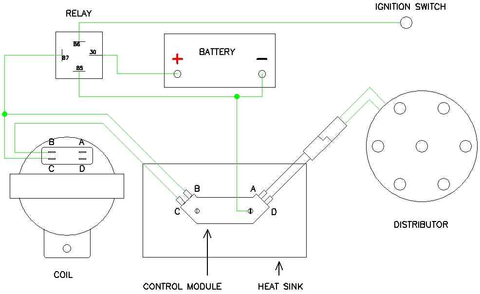

Ok, so here is the original wiring diagram (I've highlighted the relevant wires) and a diagram I made with Word of how things currently look under-hood:

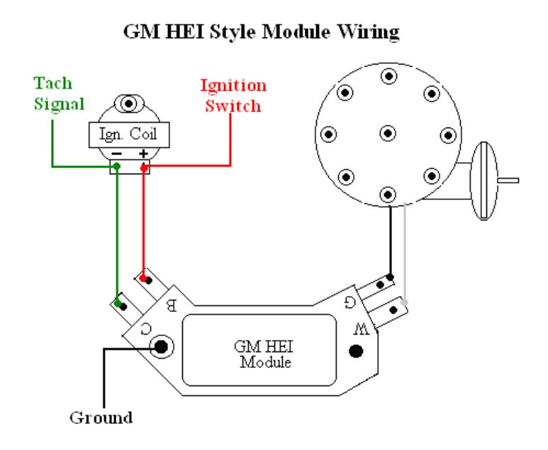

Attached are two of the most basic HEI diagrams. One with a relay, one without.
Either way, the "Ignition Switch" signal is the "Start/Run" from the OE vehicle wiring.

FYI, Your wiring diagram looks like it is correct. Maybe you should check to see if you have any wires accidently grounded, especially to the coil.

Draw a schematic diagram showing the ignition circuit. You have created a wire-run diagram. That's fine for showing how to put something together, but it's not very good for showing how something works.
Take "firewall" out of the diagram. Add the ignition switch. Delete the ground wires, but show the grounds. Why is the coil bracket grounded? You don't need that. The voltage regulator should not be drawing power during cranking so its relay should be triggered on only in the IGN1 (run) condition.
