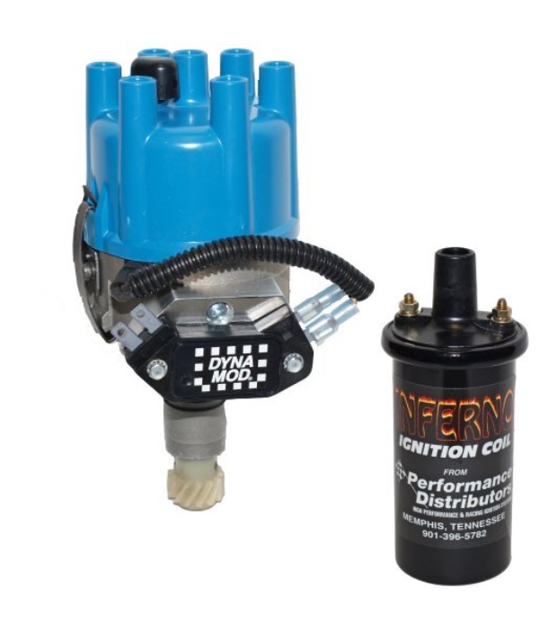

I don't get it this distributor doesn't have the vacuum advance.

Thank you for that information! Through my research and conversion efforts with the HEI I found that some Holley 1945 didn't have the, no vacuum at idle, takeoff needed for the vacuum advance. My D150 with the dual lean burn is one of them. Do you know what the work around is for this?
 Post subject: Re: Hello All
PostPosted: Thu May 28, 2020 6:56 am
Posts: 3204
the workaround for that is a different carb from an earlier model. good time to do a super 6 swap it you ever considered it...
on the distributor, you'd be better with a factory one from an older model than the one you pictured, too.
