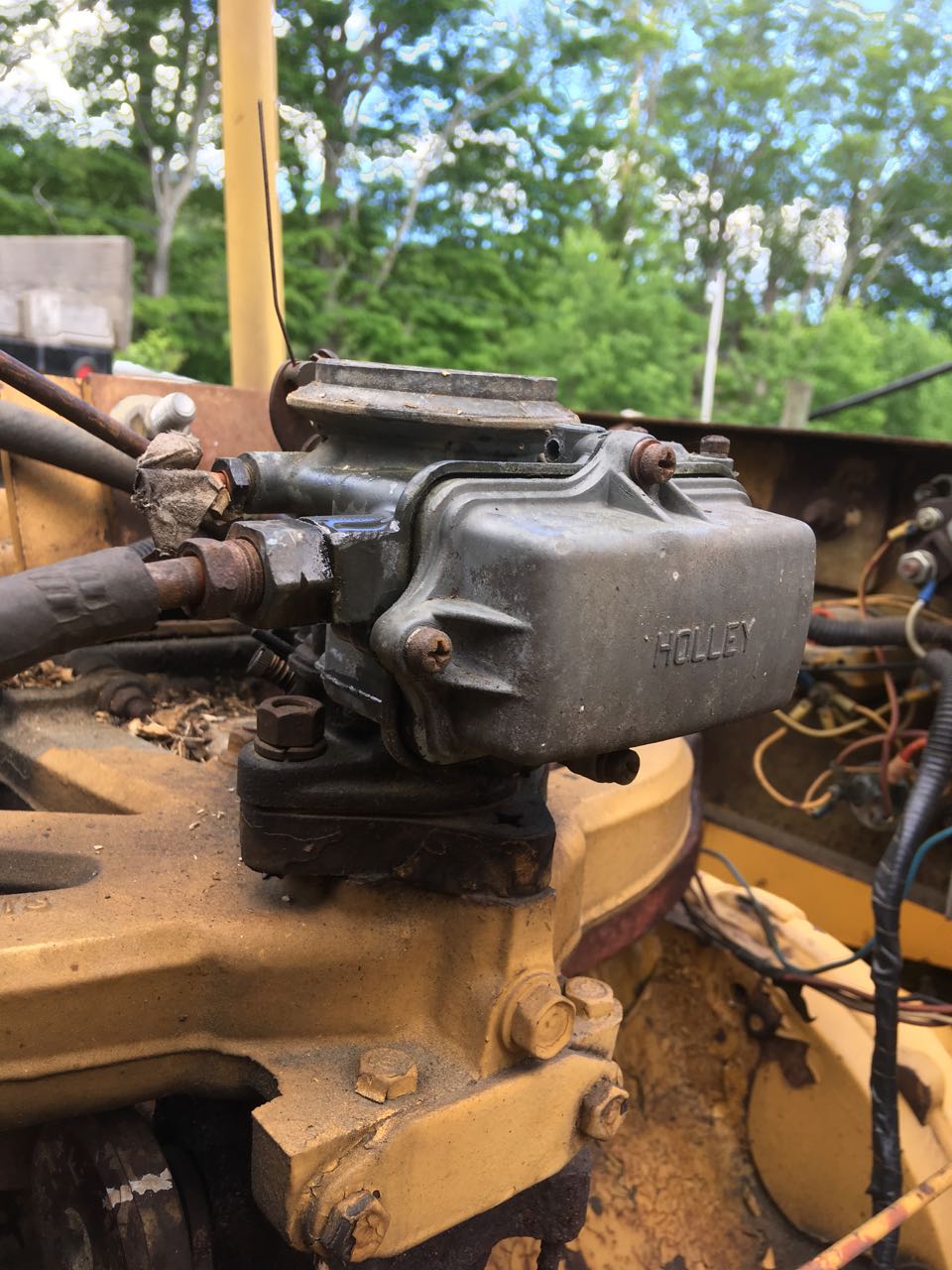

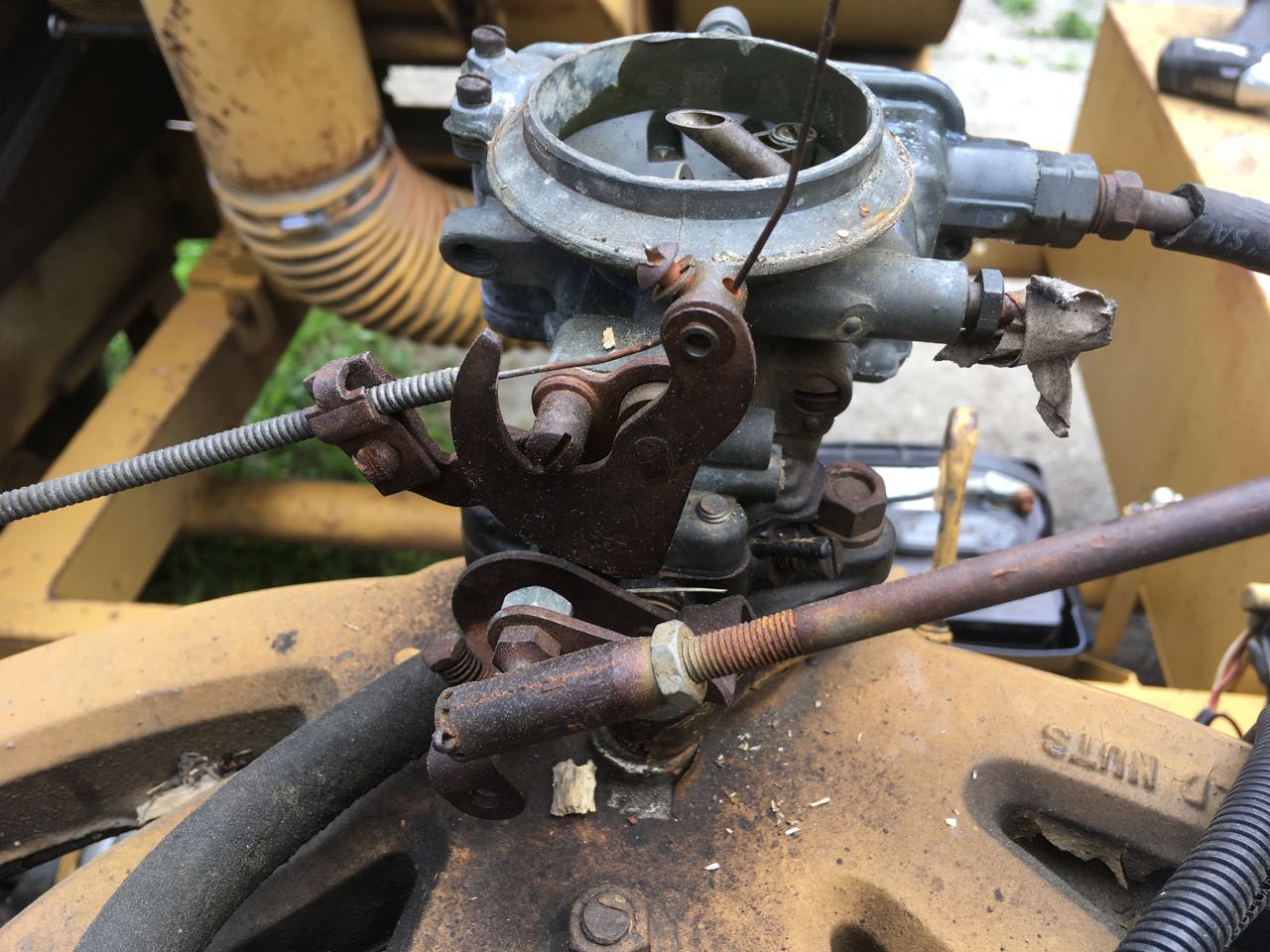

Hi there - It took a little longer than expected to get the images, but here they are. The wetness you may see is WD-40 from getting the air filter off.
Hopefully I got useful angles. Let me know if there is something else you'd like to see. I really appreciate your help with this as I have little experience with carbs in general, and little success when I do mess with them. The choke shaft seems like it has a fair amount of end to end play, but I do not know what is appropriate. The throttle shaft has less end to end, but still is looser than I might expect. Neither has much side to side "wiggle" (perpendicular to the shaft) - it does not feel like the bores are super oversized, just that they are not tight at all.
Maybe these numbers mean something? 1984 seems like the manufacture date.
Here are some overview shots:
I will put more in the next post.
Thanks for your help
Bart

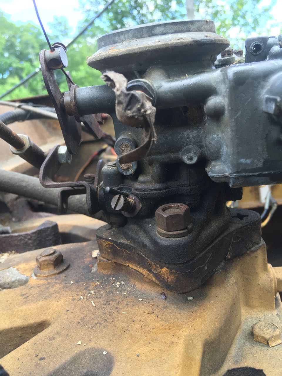

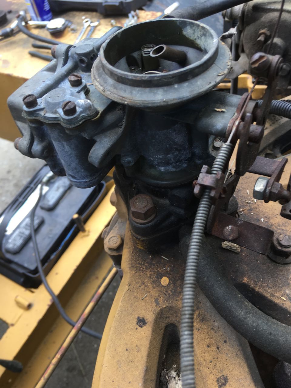

Here are some more images going around the carb body.

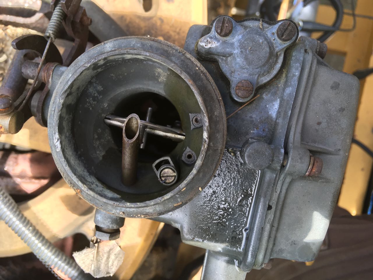

Some more, starting to look down the throat.

OK - The last of the photos. I wonder if the linkage between the governor and throttle should be adjusted. There is quite a lot of slack in it, so the throttle can bounce through about 1/2 of its movement. In other words, at fully open the plate is at 90°, and at fully closed it is at 0°. But when the throttle control to the governor is at low idle, the throttle plate has no restraint from swinging between 0° and 45°. Maybe the dynamics of a running motor make this irrelevant?
I can see how to adjust the linkages, but not really sure what my goal should be in adjusting them.
Thanks again for your help
Bart
File comment: Should there be a spring to hold the throttle plate from bouncing?

PostPosted: Sun Jun 14, 2020 2:09 pm
Posts: 24929
Looks like that Holley 1904 carb was actually original equipment; if you'll search here for "6873" (the carb list number) you'll find it.
Don't know that this helps you any, but it's interesting.
