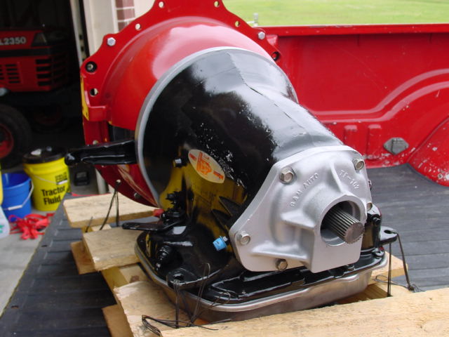

A 904 might have the same number of clutches and planetary gears as a 727, but they are way smaller diameter. There is a relationship fully understood only by the highly educated, and Keaneu Reeves, which speaks to the fact that clutch holding strength goes up exponentially with diameter.
Now, who wanted the short 727....?
But is the added clutch holding strength (a) necessary and (b) worth the tradeoff in overall drivetrain efficiency over a 904? I stand by my assertion that in most applications there is no reason to put a 727 behind a slant six.
