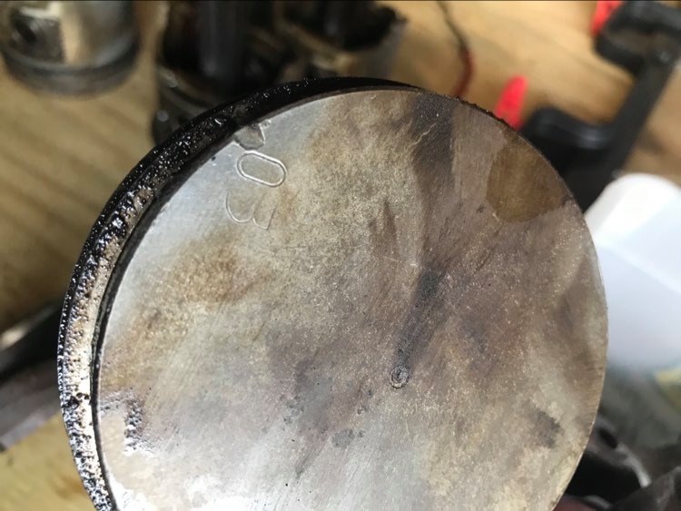

Got to the point in my 65 Barracuda (225/904) project that is allowing me to do some engine work. Long story short...I'm going to "hot rod " the slant. Offenhauser intake, Holley 390cfm, headers, N2O, head work, cam, etc. The engine was running like a sewing machine, before I pulled it and started the car's restoration. The PO (seller) didn't know much about the car, it belonged to his deceased brother and that it had been sitting since 1988. 41,000 on the speedo. Anyway, I tore it down today and was disappointed to find out that someone had been in it before. The crank had been turned, both the mains and rods .020 (Journals look fine, maybe polish)and the rods were not in their right cylinders, i.e. 6 in position 3, 2 in 4 and so on. The cylinders measured at 3.450 (std 3.400). I have two questions. #1...Should I look for a different crank, because of my pending additions? #2...On the tops of the pistons is a number near the "notch," (03) surely it doesn't mean 30 over? (see pic)

The crank will be fine. The mark on the piston could mean anything....if you are confident in your 3.450 measurement then that's that. As for nitrous, I wouldn't put that on any engine except if I owned a Chevy that I was trying to keep up with Mopars....

Did you measure the piston diameter or the cylinder bore diameter? If the crank looks good, I second that it will be just fine in a performance oriented slant. If you are only going to use a small nitrous shot once in a while, your current combination will 'likely' be ok. If you plan on regular, and/or heavy use of nitrous, you should look at something other than stock rings, possibly a chrome set? The Nitrous guys would know better about such things.

Welcome to the site. Too bad you took it apart as it probably would have been fine to withstand some HP. Anyway, crank should be fine, yep. Best to mic the bores and see where they are, then we can help you design a combo. What is your budget for the shortblock buildup, and the whole project? What kind of performance/driveability are you after?
