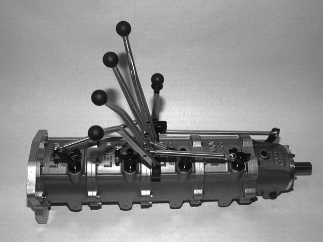

Just for fun...here's my latest acquisition...a Lenco 5 speed. Ratios 2:99 / 2:17 / 1:57 / 1:25 / 1:1 No overdrive but also not a lot of drop between gears....

PostPosted: Mon Jul 06, 2020 6:07 pm
Posts: 2756
You dog!
Man I love that Lenco, seriously cool part.
What are your plans for the trans?

Those are nice close ratios. Lenco's are bitchin' so long as you're on the throttle. For those who don't know, there's no engine braking. I'm more into road racing so I'd rather have a sequential dog box or a dual-clutch. I'm not willing to spend that kind of money so my ZF 6-speed will have to do.
