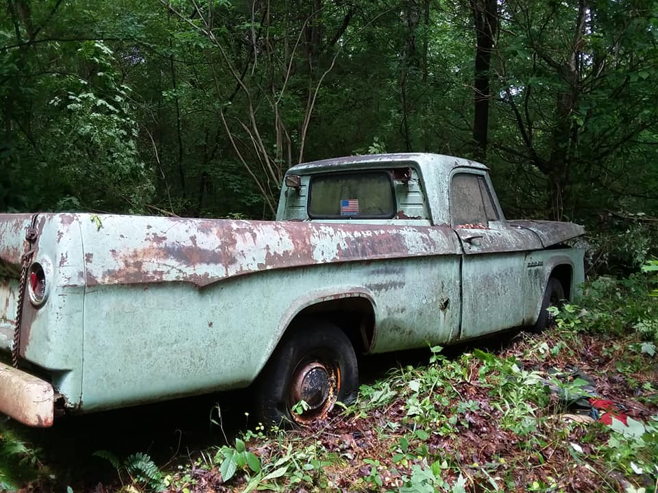

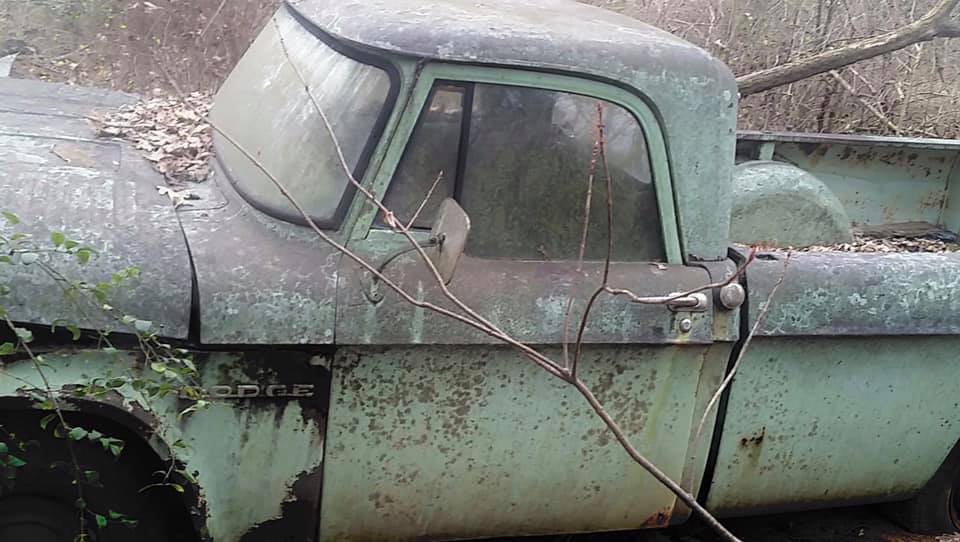

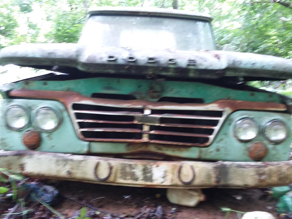

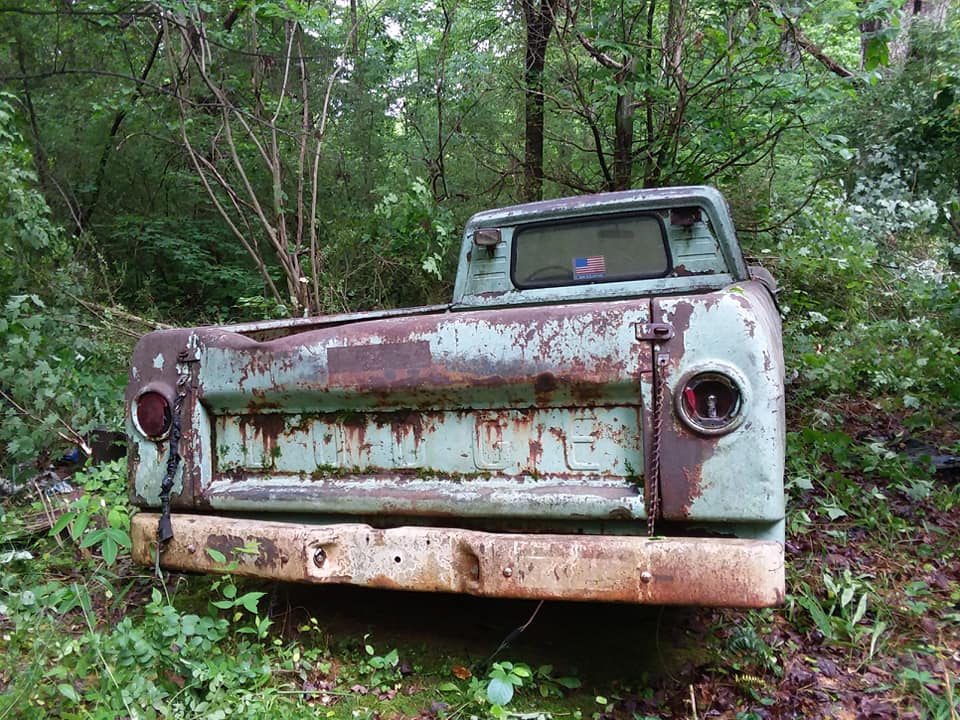

This is it the day I pulled it out of the woods.

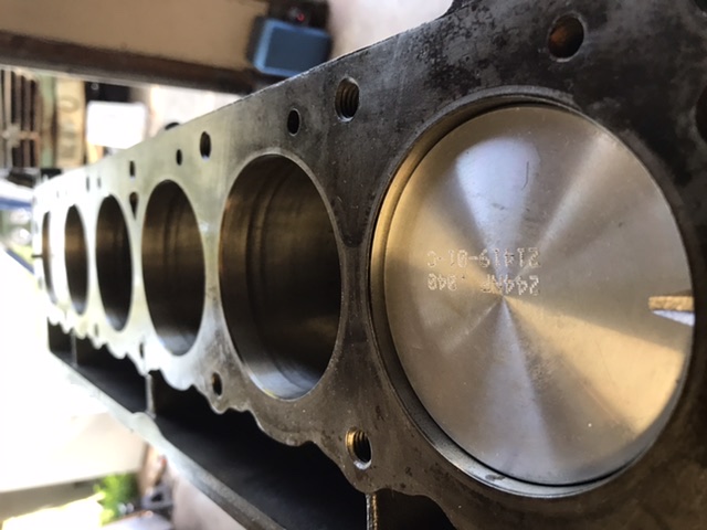

Well , it's been a minute , but I jumped back on my 225 this weekend. I do have a question , the kind of question that is going to make most of you guys roll your eyes and move on , but here goes: Why does the piston stay a 1/4" down in the cylinder at TDC on the 225? I found exactly 1 picture (over on Abodiesonly) that looked like mine. I brought work to a halt trying to figure out if if I had mixed up parts (I'm using two 225 motors to build one good one) , but when I rotated the piston to BDC , it was 4 1/4 (ish stroke... I used a tape measure) , and I measured both sets of rods from the motor I am using , and the parts motor , both the same.
I've never rebuilt a slant , have a 318 , and a number Japanese motors , as well as GM cast iron V8's. On those , the piston is right at the top of the block TDC , not almost to the top. Anyway , until I found that picture last night , I was a little thrown.

Pic of motor

PostPosted: Tue Sep 08, 2020 5:04 am
Posts: 1482
Yes, this is 'normal' on a slant. It is not a 'zero deck' motor in stock form. This is why most slants average 7.5-8.5 compression from the factory.
PostPosted: Tue Sep 08, 2020 5:24 am
Posts: 9094
Actually a 170 slant is a zero (or close to zero) deck slant. The 225 and 198 have the piston down in the hole. Just a FYI

Thanks guys.
