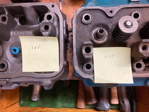

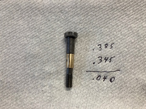

So I came up with a different solution. I made a bushing to fit over the necked down shank of the hydraulic head rear mounting bolt.
To know where I was starting from and to find the differences in what appears to be the oil to the rocker arm choke point I measured a hydraulic head and a mechanical head rear rocker shaft hold down bolt shank and clearance bore.
The measurements are on the photos below.
To have a place to start I made the bushing diameter to set the choke point to .040
The clearance was .112 on the hydraulic head. The mechanical head was set at about .100
I will fix the bushing to the bolt with a removable pin, so the bushing is removed with the bolt. If the oil flow is not right, I can remove the rear rocker bolt, remove the retaining pin and push on a larger diameter bushing to further reduce oil flow or a smaller diameter bushing to increase oil flow.
The bushing will go on the shelf for now as I like the increase oil to the lifters - camshaft during the break in, for the first 500 miles or so. after that I will start pushing the rpm's and be more concerned over getting more oil flow to the rod and main bearings and I will install the bushing.
File comment: bolt shank diameters
File comment: bolt hole diameters
File comment: bushing on the bolt
