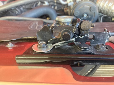

Yesterday while driving the 83 D150 ( at low speed) noticed the hood was up against the safety latch. Stopped and closed the hood, in a matter of minutes of driving it was back up again.
Today I looked closely at the latch. There is a semi rotating claw that closes over the hook on the hood. That claw is retained by a dog latch that swings into a stop when the hood is closed.
To open the hood ( mine is a factory cable release) the dog latch is pulled back from the claw alowing the claw to swing open.

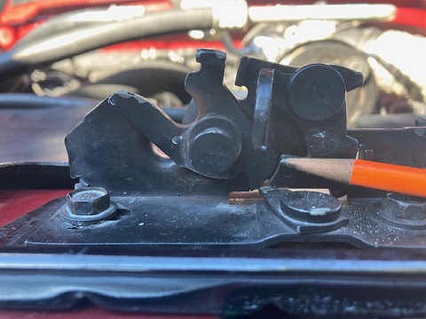

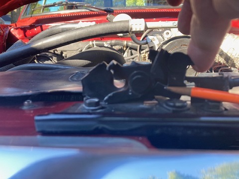

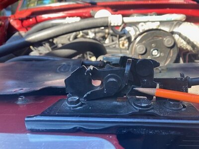

The problem seems to be there is nothing positioning the dog latch to lock into the rotating claw when the hood is closed. See photos below. For someone that has a mid 80's D150, is something missing from my hood latch. It was functioning fine for the last 37 years until yesterday,,,,,
I don't see anything obvious, I have a 83 FSM and a parts manual, neither has a photo or drawing with enough detail to see anything helpful.
File comment: dog latch in position with finger pressure
File comment: dog latch not moving into position
File comment: hood latch open lock retracted

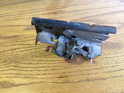

I talked with Charlie S, he gave me a verbal description and then I found a photo on the internet,
the torsion spring on my latch has gone AWOL,, I'll find a suitable replacement.

Added a spring to do a temporary repair. The spring pulls and holds the dog leg latch into position when the hood is closed.
Photo shows the temporary spring and the dog leg in the locked position

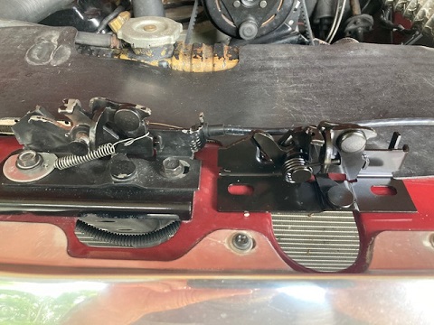

The new latch from LMC arrived. In the photo the OE latch still installed with my temporary spring is on the left, the new LMC latch is on the right.
Did a visual comparison, the re-popped latch sure looks identical to the OE part, metal thickness the same, rivets the same...
I am sure that if I could buy a replacement 1983 D150 hood latch across the service counter at my local Ram dealer, it would be more than $29.00
Installed the new latch and it works fine.
