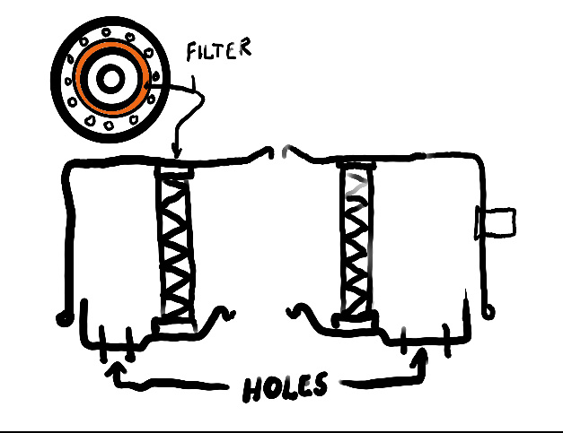

Any holes would be outside of the actual filter. There is about an inch of concentric area outside of the filtered area, yet inboard of rhe filter housing diameter. All air would still be filtered, and would come from exactly the same area as the original drew it from. Think of an arrangement of holes on the horizontal bottom of the lower plate. Like a telephone dial, or cop car dog dish hubcap. They wouldn’t show at all. And, they may not increase performance, but would absolutely insure that the original design wasn’t able to decrease it either. I’m not looking for performance gains anyway, just a good running old 6 in my daily driver truck.
PostPosted: Wed Oct 07, 2020 12:02 pm
Joined: Fri Jul 07, 2017 6:03 pm
Posts: 38
Location: Lawrence, PA
Car Model: 84 D-100
File comment: This might explain better.
PostPosted: Wed Oct 07, 2020 12:09 pm
Posts: 2946
Location: Gilbert, Arizona
You could drill holes, but it would be easier to trim the overhang from the bottom plate. Not sure if it would help, but it would open up even more potential airflow.

PostPosted: Wed Oct 07, 2020 2:21 pm
Posts: 38
Car Model: 84 D-100
Seems as if that might compromise the rigidity of the part though. The vertical outside rim of the lower plate stiffens it substantially.

PostPosted: Fri Oct 09, 2020 11:02 pm
Posts: 2946
If memory serves, there is a downturned lip just outboard of the filter element that should provide sufficient rigidity. In fact I see it in your drawing as well.
