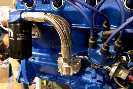

PostPosted: Thu Oct 22, 2020 5:10 am
Posts: 1481
It is a little fancier than it needs to be, but this is the setup on my race engine. I am not a big fan of the upside down oil filter either.
