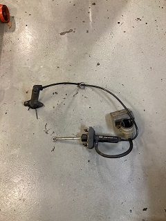

PostPosted: Tue Oct 27, 2020 6:24 pm
attached is a photo of most of the hydraulic clutch working from an 87 D150,,
the clutch cylinder
the reservoir
a portion of the slave cylinder that attaches to the throw out bearing arm,, I should have the missing slave cylinder, somewhere?
these parts should be considered as set up parts, no guarantee that they are suitable for your use or functional.
if this will do you any good, I will send it to you for the shipping cost,
if interested send me a PM
