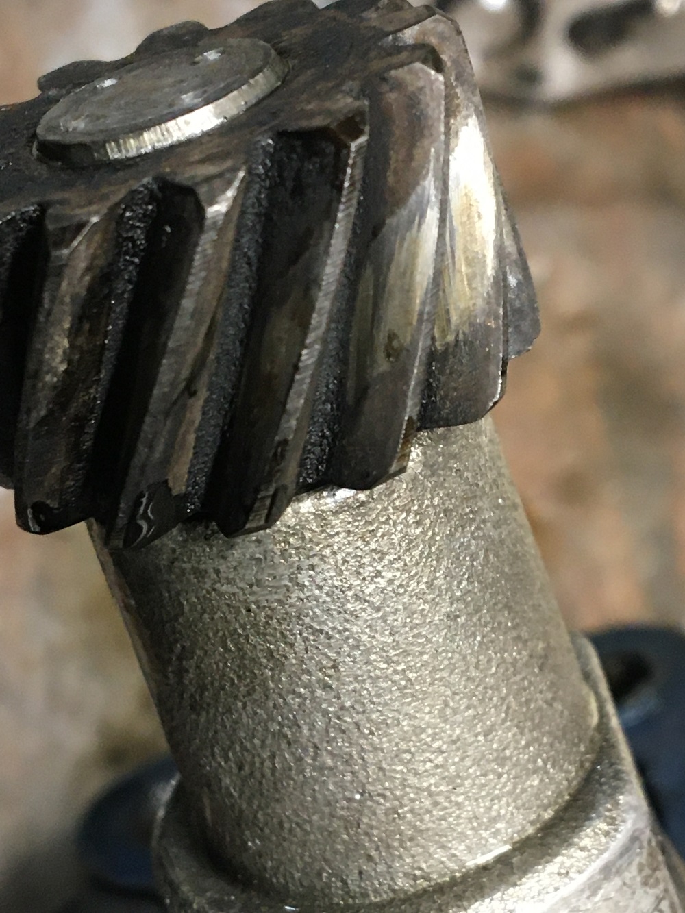

Pulled he pump and the gear looked pretty good to me. Very minimal wear that I could see. I will post pictures later today.

Here is the pictures of my gear on Doug's pump which I ran for about 1 hour 15 minutes. The gear looked pretty good to me. It is very hard to get a good picture of a gear like that. The original old wear pattern is obviously easy to see after 120,000 miles. The wear pattern from that last two days comes across the center of the gear and is just a little more shiny. It actually looks kind of bad in the picture but not in real life. :D

My new pump was installed and everything is working good.
