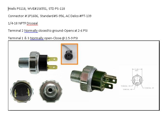

Rick, This is the oil pressure switch I am using. I like it because it has separate terminals for the relay connections and the 'ground signal' for the dash indicator light. I also like the fact that it fits the slant oil pump without an adapter.

What about this ?
If I use Matt's drawing. Change my shut off switch to normally open. Could I not just manually ground the #85 wire before the switch just for start up?
The 3 prong switch looks like the factory 85 Dodge truck oil pressure switch.

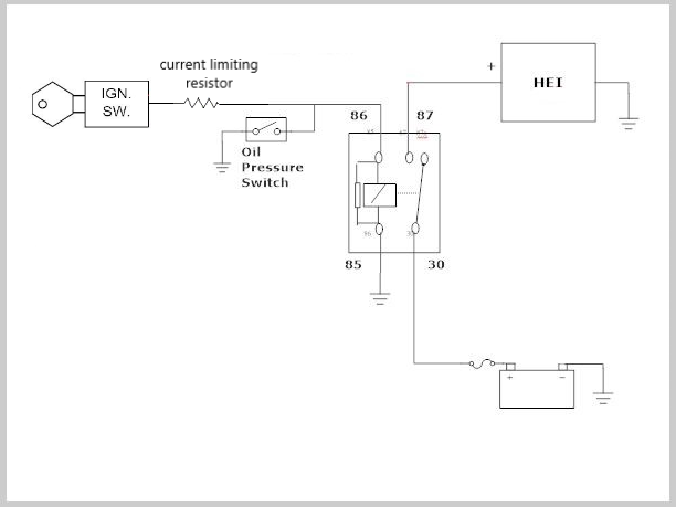

Put a current limiting resistor in your ignition feed to the relay and you'll stop blowing fuses. Move the oil pressure switch connection to the relay coil. The oil pressure switch will pull down the voltage to the relay coil so that it opens. If you want to be able to start the engine without oil pressure put a switch in line with the oil pressure switch to disable it. Don't do this in a motor vehicle! Only do this for circumstances where losing engine power will not endanger life.
