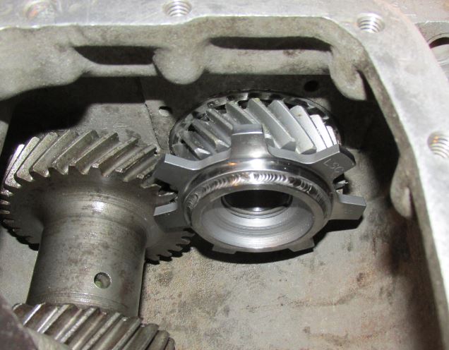

I had to make a little shorter dummy cluster shaft to get the cluster installed.
The case modifications made it a little closer inside the case.
After figuring that out I got the cluster and main input shaft in.
Actually, input shaft in first, then slip the cluster up and install the shaft.
I did figure out I could put it together easier if I was left handed!
Here is 4th gear in the case.

what is modified inside the case to require that?
is this an aluminum case?
PostPosted: Fri Feb 05, 2021 7:44 am
Posts: 2701
My case is aluminum.
Liberty installed steel countershaft bushings front and rear.
The rear one is notched for the brass thrust washer, so it will slip in like stock.
The forward one is not notched.
So you have to position the front one on the bush and the back one on the cluster.
That is why I needed a shorter installation shaft.
You would not need anything to put it in a stock case, steel or aluminum.

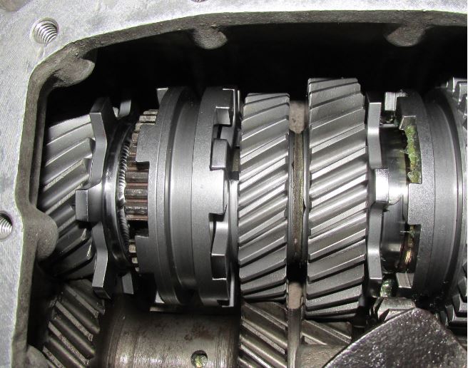

Got it together today.
Instructions would help, but it works its way out after some stops and starts.
You have to put the box together like an OD box with the cluster in the bottom of the case.
After getting the mainshaft in, then you put the cluster back in place.
The input retainer is on my mock up trans, so I have to swap that out.
Looking forward to seeing how this all works out.

Let me know if you need more pictures, I took one at every step so I used it as a QA process.
This way if I way if I wake up in the middle of the night wondering if I put a snap ring in, I can look at the pictures.
Today I figure out which side cover and get a weight on the assembly.

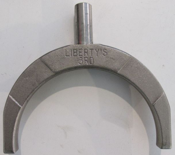

One more picture, the custom 3-4 shift fork.
It's got extra offset.
