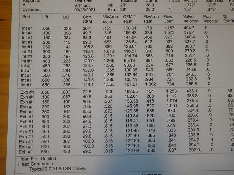

Sure. I was just coming back to do that. The first sheet is after and the second is before. Keep in mind, these numbers are without any back cuts on the valves at all. Just a single 45. Also this is without the valve seats retouched. Both of which will add a bit more flow, once I get that done. Jerry said this head was the hardest iron head he's ever seen. Said it has a very high nickle content because it was constantly showering sparks the entire time. This is the last iron head he said he'll ever do.

PostPosted: Sat Apr 03, 2021 5:51 am
It's interesting that the exhaust side is a more responsive port than the intake. On the intake, it's pretty much all done by .400 lift.
