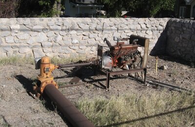

PostPosted: Sat Apr 03, 2021 6:01 pm
Posts: 2711
I took this picture a few years ago on one of my southwest trips.
PostPosted: Sun Apr 04, 2021 6:51 pm
Posts: 10360
Nice Irrigation Setup!
PostPosted: Mon Apr 05, 2021 7:20 am
Posts: 9146
You see those all over the place in the Southwest. Once I became a Slant 6 fan I would always check to see what the pump was. I found a couple Slanted ones over the years. Cool stuff.
PostPosted: Tue Apr 06, 2021 8:44 pm
Posts: 418
Location: York NE
Mine does not have the legs or the driveshaft and pump but otherwise looks just like that. It sat outside in the weather neglected long enough that the plug wires were falling apart, the hoses were crisp and the oil bath air cleaner had rust holes all the way through. I don't figure that much of that engine will be usable, but the radiator still had green antifreeze in the bottom below the break in the hose and the rest of the setup seems ok, the clutch still releases!. I got it cheep, the farmer wanted it out from beside his driveway where it had been moldering for a long time. I think I paid about $50 for it and he helped to load it.
Dave
1972 d-100 parts truck
