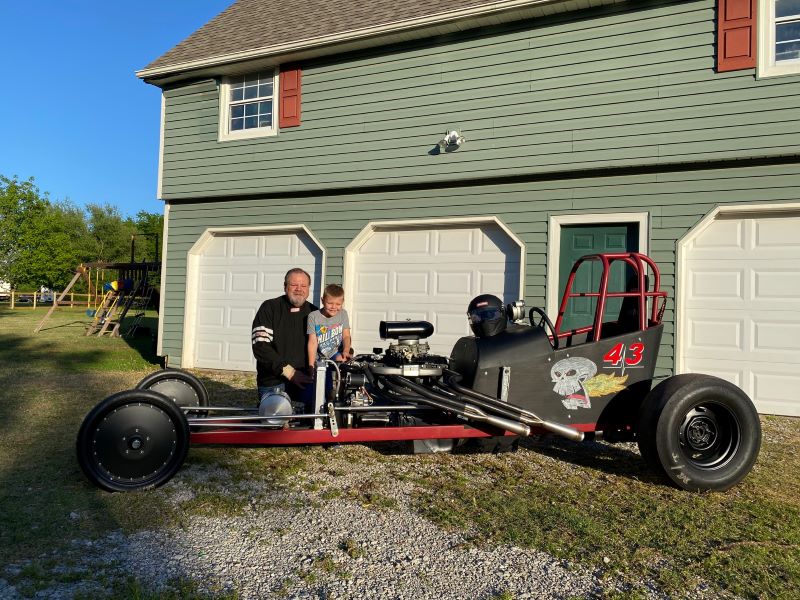

No quarter mile time?
Can anyone post a picture of his 'car'?

We were not running the quarter mile at the Spring Hot Rod Reunion, only 1000ft in Slingshot/FED class. The SDRA class also ran the 1000ft with a 9.50 second index. I took runner up in FED. I totally botched my dial and broke out in the finals.
I'm looking forward to meeting some new faces and having fun at the Mopars Invade at Mokan. I'm sure there will be some good racers and close races. I am NOT planning any crazy trips out east. So you Slant Six guys need to come to Mokan to get a jump start on your points lead for 2021!
So what did I do to the car over the winter to make such a big improvement? Basics! Basics! Basics!
The bores were not round or the right size for the pistons, so I got that fixed. The rings were Total Seal brand, but designed for a vacuum motor (ultra low tension, so says Total Seal) that were provided by the piston manufacture. So new rings that actually seal (Thanks Keith @ Total Seal). The exhaust valves had touched the pistons, and therefore were slightly bent, but not enough to keep it from running. So that was fixed. The intake was never ported, so I spent some time with the die grinder and stuff to get that all matched up. The stock head gasket that matched the bores perfectly before assembly, "squeezed" into the bore after torqueing the head bolts, and the fire rings were almost burned through, so a new overbore head gasket was installed. A new 8" torque converter from a well known Slant Six guy replaced the almost stock converter I used in 2020. And a major diet for the #43 for some weight savings. I hope to get some additional "improvements" completed by the Mokan meet, but work and such keeps getting in the way.
Ultimately the plan is get the car into the 9s. The chassis is certified. Once I get it into the 9s, the goal is to get my competition license. It may take putting it on Methanol and add a trans brake to get there.
Warning! I know some of you have probably done this before, but just so all you know I'm a real human and make mistakes. Always check for the cam plug before bolting up the transmission. Those that have made this mistake know how you find out!

Could you post some more pics of your car? I would love to know more about it.

What specifically do you want to know? Engine? Chassis?
You can look up SDRA Tulsa on Facebook. SDRA is the class I built this car for. (NA inline engines)
There are pictures of the chassis build there. You have to scroll down a bit.
The engine is really nothing special. Just real high compression with flat top pistons. Milled the head way more than most would dare. Zero decked the block. Notched the pistons to match so the notch would be as small as possible. Now about 14.5:1 CR. Running 112 Racing gas. Carb is 650 brawler. No mods. Head is mild port (just clean up really) with 1.75 intake and 1.50 exhaust valves. These are the ford pinto 2.3 valves. Cam is from Racer Brown. Not the biggest cam I could go with, but pretty big.
904 trans with minimal mods. Low gear set from late model trans, TCI reverse manual VB, BTE 8" torque converter, medium depth steel pan (Mopar reproduction).
Of course I run Magnacore wires. The distributor is locked out. I use the Pertronix Digital HP ignition with matching coil.
Stock volume oil pump from Rock Auto. I did lap the drive gear and cam before final assembly.
Double roller timing chain (BB)
ATI harmonic balancer (BB)
I built the headers myself, collectors are from Burns Stainless
Water pump run by Moroso electric motor with custom bracket I made
Radiator is a cheap eebay special for Hondas
Water pump is AC delco from Rock Auto
Roller Rockers (unkown brand, but rebuilt by Rocker Arms Unlimited in CA)
Custom push rods (Smith Brothers)
What else?

Here is another pic
