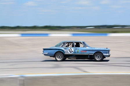

Car looks good.. what is the skirting below the chrome aluminum mouldings for?
Oil diaper?
