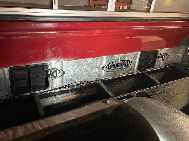

* Added a cab vent, since I changed out the door seals when I re did the truck, it takes a really good slam of the door to get it to close with all the windows up. I got a set of these vents at the pull a part. I installed one of the vents in the rear cab wall behind the driver seat. Photo below. It has helped a lot.
The transmission shifts really smooth thanks for the tips on the transmission fluid. The motor starts easily, pulls fine.

Added a cab vent,
John, I take it you were able to install the vent with the bed on the truck? What are they off of. That is a really good idea.
 Post subject: Re: 83 D-150 Project
PostPosted: Tue May 11, 2021 4:09 pm
Posts: 3864
I did, used a Dremel with a cut off wheel to cut the opening. As the vent mounts from the inside was easy to put in. Not sure what the vent came from.
Too many Pull-A-Part trips.

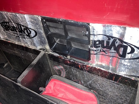

I added one cab vent last winter to help evacuate the air out when closing the doors with the windows closed.
That made a big difference. I had a second vent and I installed it.

I got the cab vents from the pull a part years ago,
It is Chrysler part number 4432752
mine came from an '88 D150 but I bet they were used for several years.
Looks like Dodge put them in the door, I put mine on the back of the cab.
