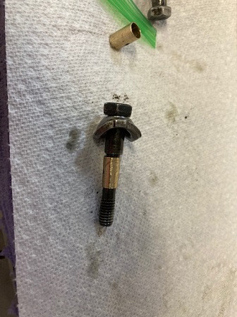

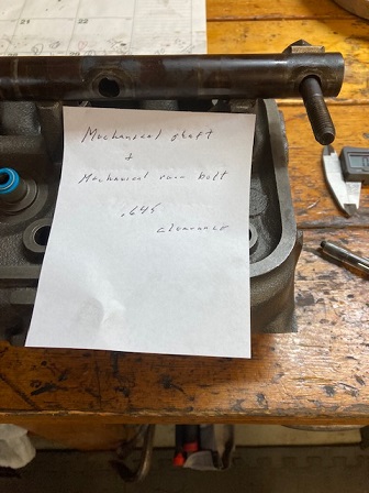

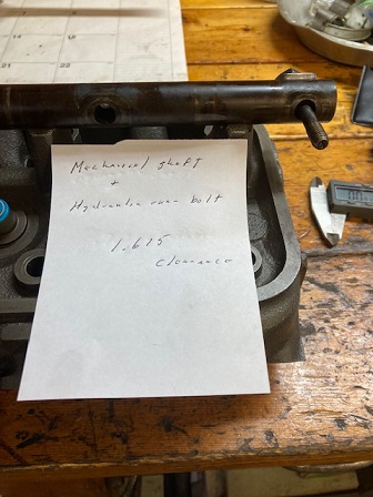

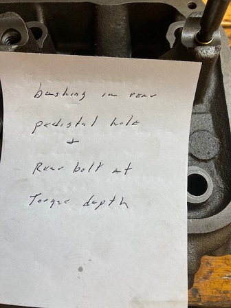

I did not restrict the oil flow to the head as part of the build process, so I am backing into that by using a brass bushing at the rear oil feed rocker arm bolt.
Listed below are photos with clearance information.

File comment: .645 clearance
File comment: 1.615 clearance
File comment: .605 clearance

I did some visual observations today looking at oil to the rockers with the mechanical shaft and the hydraulic rear bolt with and with out the bushing. Tomorrow I plan to do another test and get variable data collecting oil that spills out of the head. We shall see how that goes.
I guess my question is: how much oil is needed going to the top end with a mechanical valve train at low and high rpm's? Just a dab will do ya, or a lot? And anyone agree that a lot of oil up top will cause positive valve seals to ingest oil, or is this maybe the rings just have not broke in yet?

installed the hydraulic rear rocker shaft with a bushing that reduces the oil passage clearance. My visual observation is that I did not see a difference in the oil flow to the top end. But directionally this seems to be the right thing to do, although certainly the way things are I do not see oil starvation valve train issues in my immediate future :D . I will take the recommendations that I drive the car, break in the motor and re evaluate from there, so that is what I will do. Thanks for the recommendations.
