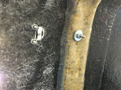

I got the trunk lid all done today. Trimmed about 1/8" off the back edge where the green tape is shown. Put a small tab in the center underside for the prop rod. Also put some round rubber washers between the hood pins and the deck lid to protect the paint when completed. Then I block sanded the whole thing and it was amazingly flat. :D :D Now it is up to the paint man when he want the car. :D :D
These bolt heads will get cut off once the hood pins are on for good. Rob will removed them to paint for sure.
