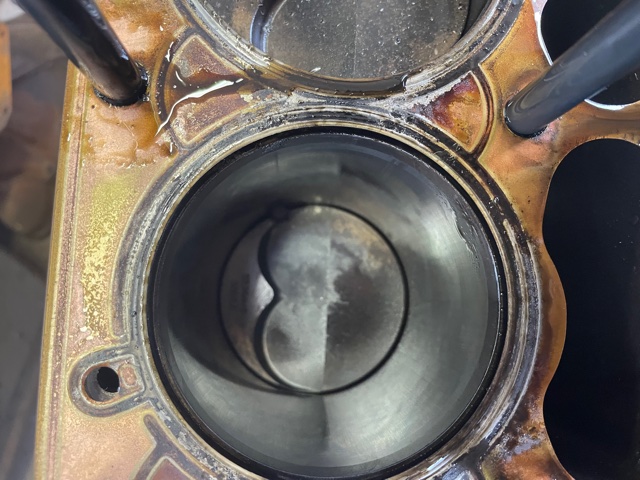

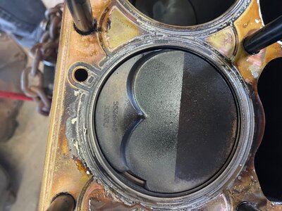

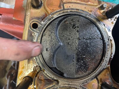

Hello, I have been running a torqstorm supercharge on my rebuilt SL6 and have about 2000 miles and a dozen runs down the strip and blew it up. I have been running out of fuel on the runs and am working on the fuel delivery but the pistons came apart so that is my big problem. To rebuild and how to determine what went wrong with what I had. I am adding some pictures of the pistons for reference. Any ideas of help would be appreciated. Head, valves look OK, it feels like I can hone the walls and clean up any scum but adding teh same pistons back in seems like I would create teh same problem. Thanks!!

It seem obvious that if you are not getting enough fuel on a run it will go way too lean. Lean mixture will cause detonation will destroy the pistons.
That's what it looks like to me.

Yes, that is a burnt piston, in this case the piston was the victim. The piston was not at fault.
Have to agree with the above post, the most likely cause was a lean fuel mixture, but it also could have been to much ignition advance. Are those hypereutectic pistons? You can put forged pistons in, but if you don’t fix the lean or advanced ignition issue,,you will burn those to.
Are you running an AF gauge with an O2 sensor. That is really a must with about any motor running boost. A way to data log while running hard is also just about a must.
Data logging can be as simple as a go pro device capturing a view of the AF gauge during the run. But that’s very limited data. Getting the fuel mix and rpm, air in and out temps and manifold pressure would give a better picture of the engine when pressed hard.

Did you open up the top ring gap for boost? That looks like the excess heat butted the rings and broke the lands.
Boost is an unforgiving mistress.

I have experienced the same type of failure in my boosted /6 a couple of years ago. Your pics show signs of detonation. Beside the broken ring lands, I see hot spots and small dimples. Tight ring gap may have caused the broken lands but I suspect detonation is the root cause. The pistons appear to be wiseco forgings with 6cc valve notches and the head gasket looks like a .020" steel shim. That combination along with a 58cc chamber ( common stock size) will net a comp ratio closer to 10:1 which is dangerously high for a boosted /6. You should check that out before re-ordering pistons. My engine had the same pistons but with a thick copper head gasket and 62cc chambers to yield 8.9:1 compression. With 10 psi boost, everything had to be right on in the tune. The pistons failed from a lean condition that lasted less than 4 seconds as shown in the data log. I found that a plugged fuel filter reduced pressure enough to cause the lean condition. To keep mine alive, I use 94 pump gas, water/meth injection above 4psi (460ml per minute) , 17degrees ign advance at peak torque and 19 at peak hp, 11.5:1 a/f ratio, cold air intake and an intercooler. Higher compression ratios with boost requires careful attention to details. I don't want to seem like a smart ass but I can speak from my experience. Hope this helps.
