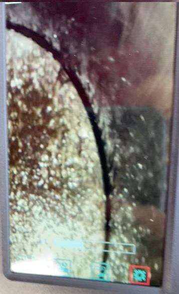

Thanks - I've been trying this (seafoam intake cleaner, oil, even tried some diesel). No dice so far. When I put liquid into the cylinder through the spark plug holes, I can hear it just dripping through into the oil pan...
A couple more things: The car will run and get up to temp idling, but if I try to drive it, within a mile it will blow the oil breather cap and the pcv valve. It blew the oil cap hard enough to put a dent into the hood from the underside. :(.
Also, I bought a boroscope camera this weekend and took a peek down the affected cylinders. Couldn't see much due to the angle, but I've attached a couple pics of what I was able to see.
Thanks!

Uh-oh.. that does not look promising..
I am far from the most experienced here on the forum, but it looks to me like your second picture shows the top of the piston missing, and the piston ring is showing...
If that is the case, then I am guessing long term heavy detonation killed your pistons, but that is just a guess.. and it is a wild guess, so it could be wildly wrong..
My second guess is that gas is making its way past both of your dead pistons, and accumulating in the crank case until the vapors ignite and that is what is blowing your oil cap off.. If you smell the oil on the dipstick It will likely smell strongly of gasoline.

I broke a piston in my slant six and pushing oil out the breather cap/blowing the breathing cap out was a symptom. Since you are sure that the valves are opening and closing and the lash is not different from the other valves it looks like you are going to have to get into the block and see about pistons and rings.

Agree, that second photo looks to be a burnt piston.
The only fix is an engine tear down and re build.
