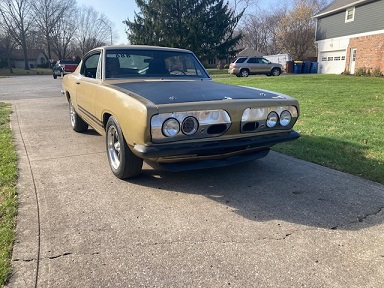

I worked up an alternative front grill for a couple of reasons.
1) to do something different and take a few more pounds off the front of the car
2) to have something on the car while I renew the OE front trim.

Posts: 3864
update on the front end - grill revision
Made new mounts for the B Body head light bezels, used light weight aluminum for the brackets. The '67 Coronet headlight bezels and grill section are secured. I like the look.
I was wanting to do a front end treatment on the 68 Barracuda that was different from stock, but still retained the appearance of something that Chrysler could have done in that era.
I wanted to give the front a unique look but not modify any of the OE 68 Barracuda sheet metal so it would be easy to change it back to stock.
The next part of this project will be re making the radiator ducting and finding a spot for the front turn signals.
The second photo is really close to the final product, I need to decide if the bezels and grill get polished or blacked out or are a combination of the two. There will also be trim added to the grill edges of the nose cone section.
The last photo is the 68 Barracuda masquerading as a late 60's Dodge B body
