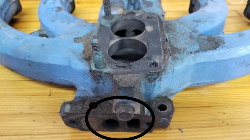

Does your Super Six intake have an EGR Valve, or at least a mount for one? If it has the mount for the EGR and you don't have the factory exhaust mainfold bolted up, the chances are very high that you will have an intake leak, especially if you don't have an EGR valve present.
Pictures would help.

Doesn't have one. I will check. Dumb question, but where would I look? I thought EGR valves were on the exhaust manifolds.

On the slant, the EGR valve is just below the carb mount on the driver side of the intake. If nothing is there, you will need a block off plate to prevent a vacuum leak.
Here with the EGR valve bolted on.
Here with it removed.

Thanks, Matt. Will check it out tomorrow morning. I have used that intake for a long time, but maybe things have just deteriorated.

Filled those holes w/ the orange RTV and blocked off with a flat piece of metal in addition to the piece that was already there.
Then I bought one of those EGR block-offs that they sell on Ebay and used the gasket that came with the intake/exhaust manifold and bolted that up. Not sure what I am blocking with that one, though.
