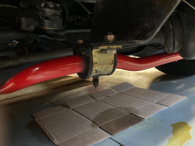

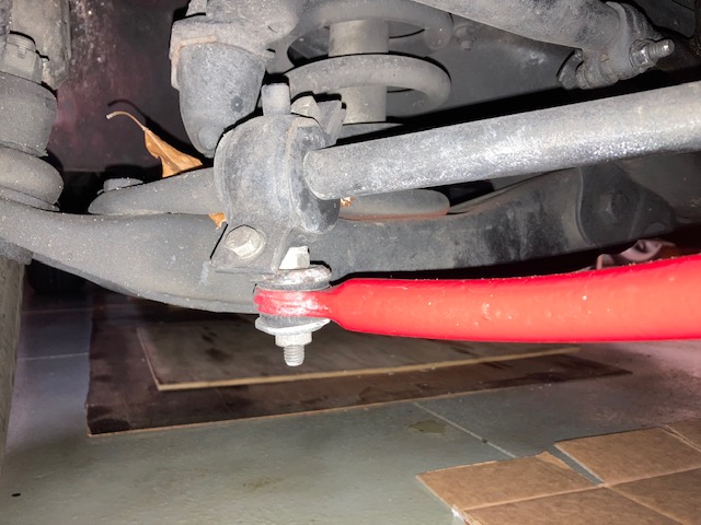

PostPosted: Wed Dec 08, 2021 9:51 am
Posts: 3864
Too many years ago for a part number, but it should be a common ID and OD, I do remember splitting the bushing to get it on and remember to get the OD a bit oversize to allow for some compression.
Looking at the sway bar today for the photos, the center link bushings and collars are obviously some current aftermarket pieces.
I had the sway bar powder coated and it has held up well.
