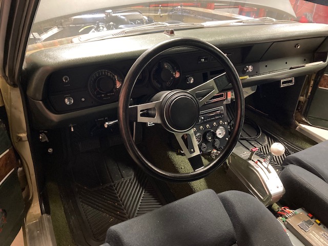

The OE steering wheel in the 68B, for a 50+ year old part is about perfect, no cracks, scratches, or wear so I really did not want to subject it to a lot of hard tugging like one would get into with Autocross.
I also wanted a wheel with a little thicker rim and a more racey appearance. For me a Mopar Tuff Wheel was the answer.
Getting the Tuff Wheel was easy, getting the steering column adapter to position the flat Tuff Wheel about where the dished OE wheel sat was more difficult. New adapters have been out of stock at the aftermarket suppliers since at least last August. Occasionally the OE adapters from the 70's are listed for sale and last month I bought one.
Finished up the install today. I like it.
The OE 68 steering wheel and the Tuff Wheel are in the photos below.

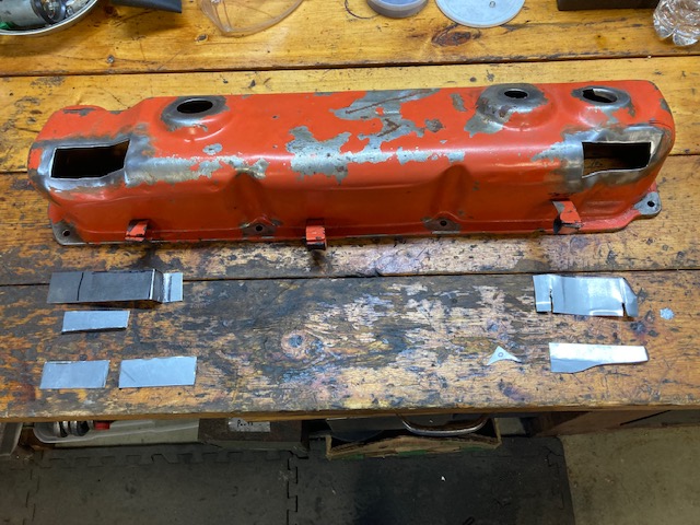

This post shows the Roller Rockers and the valve cover revisions made to provide clearance for the rockers inside the valve cover after the B3 spacers were installed.
The B3 spacers moved the rocker shaft up a bit over .200 I checked the clearance with molding clay, rolling the engine over by hand. The outboard adjusters hit the valve cover hard. The adjusters below the valve cover internal baffels just touched the baffels. This is with a valve cover gasket installed in the valve cover.
Link to the B3 discussion https://www.slantsix.org/forum/viewtopi ... 19&t=66466
To provide a safety margin I repeated the clearance test with the valve cover gasket removed and the valve cover bolted in place and made modifications for clearance.
Photos below show the Roller Rockers, the valve cover modifications, and a side by side comparison of a stock valve cover and the modified valve cover.
I applied Loctite 290 to the welds. Loctite 290 is a wicking fluid intended for sealing porosity in welds and metals.
The cylinder head I am using is a 1987 Hydraulic Head and valve cover.
