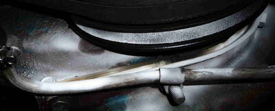

PostPosted: Thu Jun 09, 2022 10:19 am
Joined: Wed May 02, 2007 4:03 pm
Posts: 78
Location: Passssssssadena, California
Car Model: 1981 B-150 original California short passenger Van
I have a go-to way of locating the source of any leak.
Thank you for this suggestion. I’m getting what to me are ambiguous results. Here’s what i did:
1) Cleaned area with engine degreaser & water, mostly per product’s instructions other than allowing to air dry for several hours rather than running engine to dry, since running the engine could trigger the leak and spraying the powder on wet was unlikely to be helpful.
2) Sprayed on the powder. Here’s a Before picture:
3) Ran the engine for about 15 min. Here are the After pics:
Is this a combo leak of the front gasket AND somewhere up higher? Not sure how to interpret what i’m seeing, thus unsure how to proceed.

...Is this a combo leak of the front gasket AND somewhere up higher? Not sure how to interpret what i’m seeing, thus unsure how to proceed.
It looks like the front crank seal is leaking. Also looks like the joint between the timing cover and oil pan but if you replace the crank seal you will have the timing cover off and will need to replace the related gaskets to put it back together.
If I was going to dive into this job I'd also replace the timing chain, gears and water pump. Unless those things have low mileage.

Yep, It's one of those.......while your in there sort of things.
Do it now or do it again later and risk the sealing problems again.
