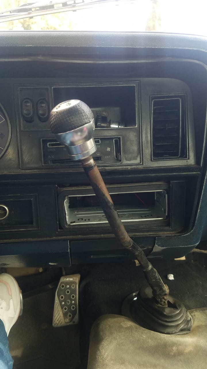

I don't think I have the OD 883 transmission though

This is the picture of the shifter

You are correct that is not the 833OD

So would that mean that my truck has the 11" clutch ?

Probably, but there is an oddball "recessed" flywheel, clutch and pressure plate that they used also. These are not available anywhere that I have found including Chrysler. Here is the link to our problems and work around.
https://www.slantsix.org/forum/viewtopi ... t=flywheel
