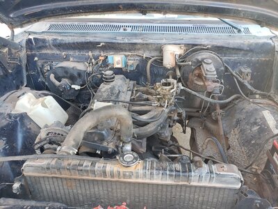

Thank you I will do that after. Get a heat shield and the fuel injection hoses. Also I attached a picture of my engine compartment maybe I'm missing something that simple that is causing the problem if you could take a look at let me know that would be great.

First thing I would do is get rid of as much rubber hose as possible, you're asking for a fire with that much rubber. I see you already have the hose draped over the top of the engine like Mr. Know-it-all's suggestion, but yet you still have a problem like I do, so what does that tell you about how well his idea works??
Maybe the shield is the answer? I don't know as I don't have one? Dims on that heat shield would sure be nice, but I'm sure that's asking to much from him to get anything like that posted on here?
Secondly, go to the car wash and hose all that crud out of the engine compartment, and the motor itself, gunk will help retain heat, and that's a bad thing! Also move the filter so it's in a up-down position, and get a metal one as plastic will melt and/or crack and also cause fire! Good Luck
