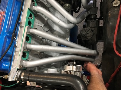

I have a picture on my build somewhere. The front half goes through the K frame so it is from the frame a good ways. 4" maybe..?
The rear tubes were modified on mine but not at the bottom by the frame. Mods were up at the top around the intake.
Rick, nice picture!
I noticed your upper thermostat housing is straight and looks substantial.
Do you remember the application?
I have the Dakota style and it's thin steel.
Seems to be ok, I like yours better.
Stan

I will have to look stan.
Stan- Summit Racing Part Number: FSS-84909 - You have to drill the holes out a 1/8" but it works fine other than that.

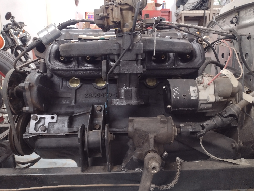

Here is what I am working with for space so far. The steering box is going to be moved more under thet starter so thats not an issue. Headers would be neat but for now I will just hog out the stock manifold opening and work with that. But i'd still like to keep an eye out for some headers if I come across a pair nearby.
