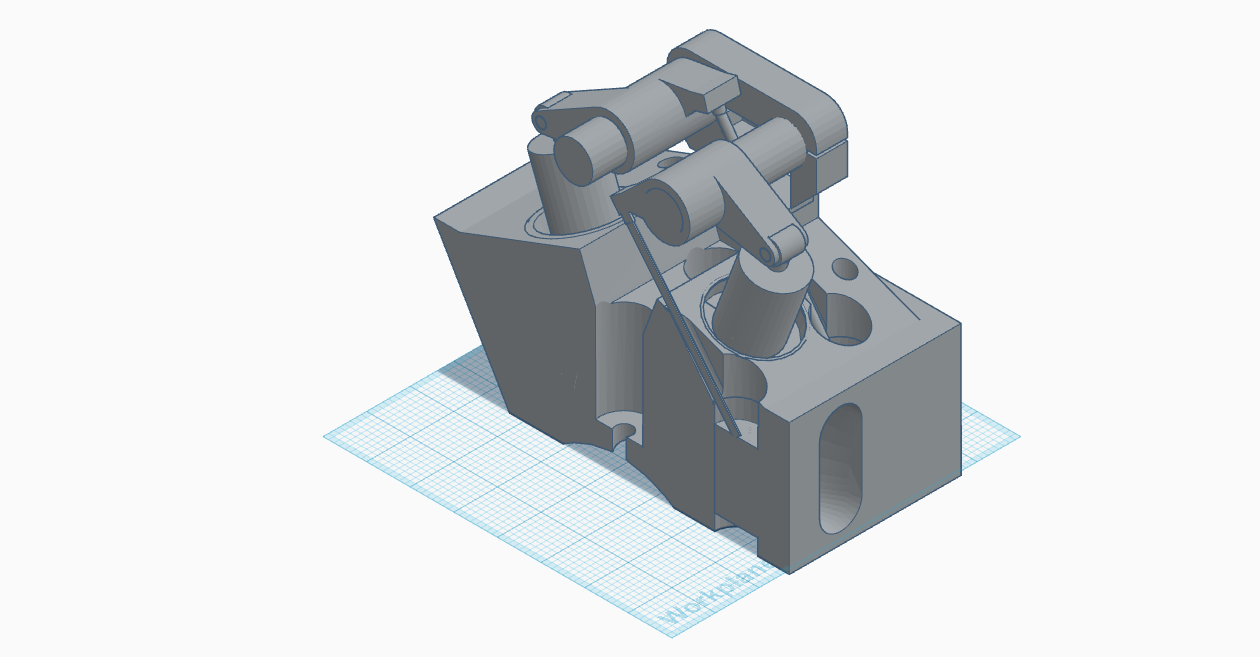

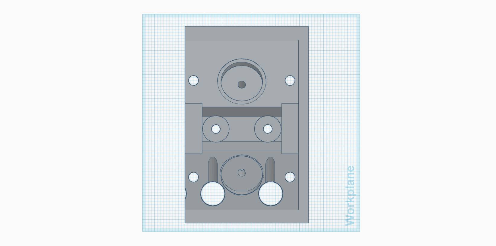

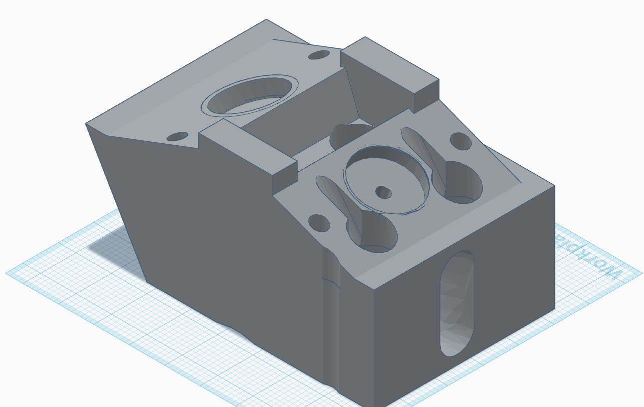

Hi, I've been stalking this forum for the last couple months, and I recently pirated AutoCAD from my school. I have been drawing and designing this in school and at home for longer than I'd like to admit. I'll try and list out as much measurements as I know. This is just 1 cylinder. more pictures soon.
Got my base measurements off of https://www.allpar.com/threads/an-insan ... ns.229890/
Combustion chambers:
spaced 4" Cl to Cl
3.5" diameter
.69" tall
3.2765 in^3 or 53.58cc
Valves: angled 20 degrees
Intake: 1.75" diameter
.341" stem
stock length
Exhaust: 1.5" diameter
.341" stem
Stock length
Note splatter:
Uses a .875" rocker shaft and 1.6 ratio rockers
This head uses a secondary set of lifters and pushrods for better angularity for the rockers
hoping to cast it out of aluminum because racecar
This design only really works for EFI systems because the intake is on the passenger side of the head while the exhaust is by the driver's side (intended for my 75 Dart)
I took some inspiration from the m12/13 BMW engine for this setup especially with a failed turbo header idea I had
I am going to 3D print this version and take it to a machine shop to have it flow tested because I have some concerns over the intake port design
secondary lifters can rise .5" before lifting out of their cylinders
I will attach pictures when I can get them off of my school desktop computer
Looking for any suggestions or critiques or insight
File comment: Here you can see in this cutaway the secondary pushrod and lifter. you can also see the spark plug tube.

File comment: top-down view of the head

File comment: crosscut showing the intake on the right and the exhaust on the left

Well....looks nice. But I think it's a case of something that makes sense when you draw it but the details end up dragging you down and kills it.
Then......I'm guessing $250K to produce the first casting. Then....time to start machining....
What this project needs is Brad Pitt. With his financial backing, it could happen.

I know nothing about nothing and won't be able to afford one anyway, but from the drawing it looks like a pretty bad angle from the secondary lifter to the push rod ??

Looks that way to me too. There's going to be a tremendous side load on those secondary lifters. A lot of lobe lift will be lost due to the geometry.

But if you intend to add water jackets you need to do that before finalizing the port shape and size.
Getting a water jacket that has a shape that is manufacturable as a core and that has the capacity to functionally address the heat from the combustion process has to be considered in the design of the port arms as the water jacket is the outside wall of the intake and exhaust ports.
Basically the section views that show the port arm shape are so close to the combustion deck, I don’t see a way to get a water jacket in there or around the valve seats.
