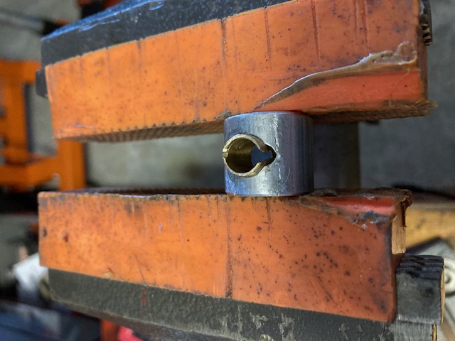

An update on the restriction of oil to the top end project.
Some background: the head is an 87 hydraulic lifter head, the cam core is a hydraulic cam core with the full groove on the read bearing journal, the oil pump is a hydraulic motor aluminum body pump with the wide rotor.
I added a Moroso canister in the PVC piping as oil was getting into the plenum through the PVC piping. That helped but the accumulator would fill in about 100 miles of highway driving.
The roller rocker shaft is raised and moved a bit off center using B3 Rocker stands. The B3 Rocker stands did a fine job of centering and reducing the roller travel across the valve stem tip.
See Photo below.
The stand at the #6 end has clearance cuts at the mounting bolt hole. I made a brass bushing to fit inside the stand bolt hole to take away the clearance between the stand's through hole and the OD of the mounting bolt. The B3 stand has two clearance cuts 180 degree apart. I also closed one of the clearance cut oil passage opening with high temperature epoxy.
Reassembled everything, re set the rockers, started the motor and watched for oil flow. The oil got to the #1-cylinder valve springs and push rods (sequentially up the shaft) but I wanted to see a bit more oil sooner.
I took it all apart and filed a clearance groove into the brass bushing. The clearance groove leads directly to the oil passage in the B3 stand. Reassembled everything and did another re start and watch for oil. At idle the oil arrived sooner and there was more of it. I will leave the oil restrictor with this set up and do some driving and monitor oil pick it in the Moroso canister.
