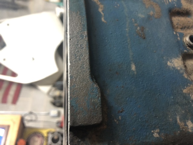

G’morning all. I’m doing my first slant rebuild. I’m working slowly through the processes, and have started taking initial measurements. I made a mistake followed instructions for a standard rebuild and it was left out to get deck height before knocking out pistons. (Stupid stupid stupid) :oops:
Anyhow, I’ve taken pictures of some stamping I don’t understand and want to see what kind of info they hold. Maybe even tell me if the deck has been cut. The pistons are stamped 09 so someone has already been in here. Including a nice Heart stamp on the #6 rod and cap. Please if anyone has any insight, let me know and I can take more pictures if needed. Thank you!

The stamping on the pan rail and on the top deck by the tappet chamber do not look like OE factory stamping to me. Just my opinion.
