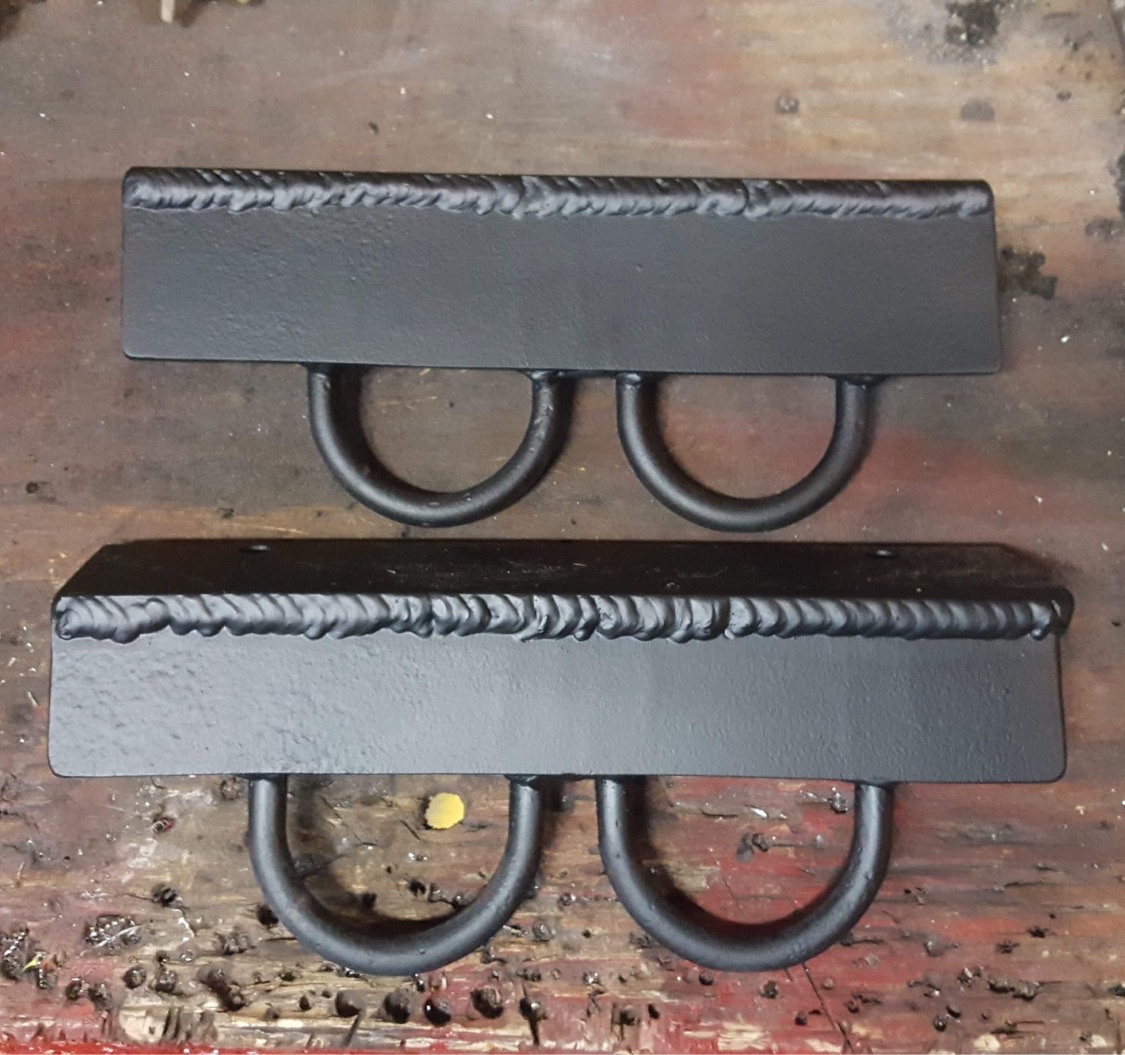

I had these made. They are reversable, one way has a circle for a hook, the other way has a slot to insert a chain link.

Hey guys, thanks for the pictures. Very helpful. They are much like the picture in my mind. I'm considering removing engine and transmission as a unit, so with two hook-up loops the dangle angle can be adjusted. The U shaped for hooks look quite substantial. The reversible one is interesting. Probably 1/4" steel plate? Maybe 3/16"? !/8 might bend pretty easily, I don't know. I don't know which design I'll try--if I have to pull the engine and I hope not.

The two lifting points are designed for either engine only (front loop) or engine and transmission together (rear loop).
It is still helpful to have an adjustable lifting apparatus to move the weight distribution. Just be careful not to have too much height to the whole arrangement or your engine hoist may not be able to lift it high enough to clear the radiator support. Ask me how I know... :lol:
