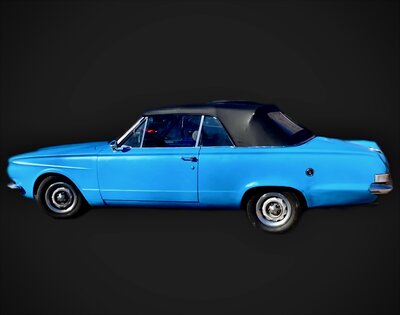

Thank you for the guide to wisdom of understanding of budget building an A Unibody car.
This forum is a remarkable find. Thank You Dan for guiding me (steering) me in to a good
place to start (stop).
Steering and stopping will be my first focus.
I have standard stock steering assembly and stock drum and disc brakes on the car currently.
