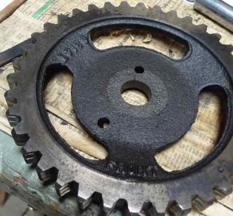

Add cam sprocket oil passage
Oil bleeds-out of the front cam bearing and builds some pressure behind the top timing sprocket.
Drill a small hole from the inner edge of the "cup", on the back of the sprocket, to the front face of the sprocket.
This directs some of that oil out to the front of the sprocket where it can be thrown around. Doing this also reduces the chance that pressure behind the top sprocket will push the sprocket / cam assembly forward.
Some top sprockets already have this feature but add it if a passage is not there.
Basically, this is just another way to get more oil onto the sprocket teeth and chain.

Figured this one out myself later in the day:
What is not addressed: Drill straight through? At an angle?
The worn part in the van has a 1/4" hole drilled at approximately a 45° angle:
I realized that the big locator slot in many of the new cam sprockets including the one i have serves the same function of letting oil flow, so for me no drilling needed.
