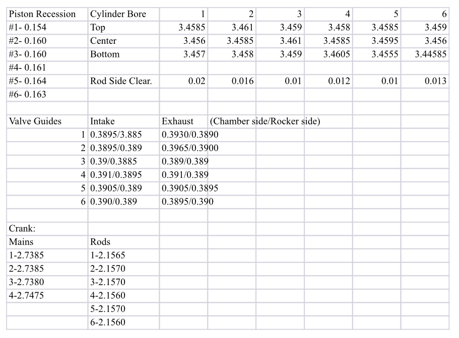

Morning Gents. I’ve worked through my measurements and was wondering how it looks to you. The rod side clearance is my only concern thus far.
I’m just starting out so let me know if I missed anything.
The pistons I have and need to replace due to major pitting, are stamped 60.
That seems to jive with the bore measurements.
As far as playing with the block I’ve drilled the fuel pump oil hole, and ran the suggested 5/16 and 11/32 long shank drill bit through the mains and the vertical head feed hole.
My question for the next step is chamfering the “downhill outer edge” of the lifter bores. That would be the top side I’m assuming. I’m also wondering what is used to cut the trench, how wide and how deep?
As for the stand off pipes, I’m having trouble finding the right threaded adapter. Where can I get the correct piece? Included with that, does anyone have a diagram where to drill the extra holes possibly needed if the stand off pipe method is used?
I know. Lots of questions. I would appreciate any and all help!
