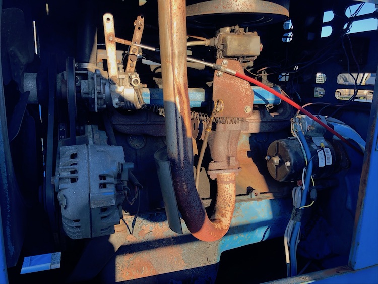

The serial number for our engine is E594444, and there is also a part number 4417679, although I haven't been able to find the magic decoder thread I've seen mentioned to see what these mean. I have attached some pictures of the engine as well. I was reading another thread that mentioned a different place to look on the block for more identifying info but I forgot to do that when I took the pics. I can certainly get that info if it will help.

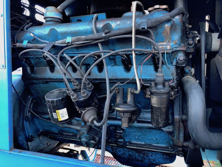

What type of drive is on the rear of the engine? Standard shift/clutch, automatic (automotive style), hydrostatic drive, etc? Can you post a picture of the valve cover, in particular the front, spark plug side? Need to see if it has a "dog leg", or straight.
Edit: Just noticed it has the dogleg. That means it is the later style (1981 or newer) hydraulic lifter engine, with a cast crank, and the large crank pilot/flange.

I seriously doubt if there is a different rear block-bell housing rear flange bolt pattern. It would be cost prohibitive to make a major change for a low volume application. There could be a special adapter similar to the 727 transmission adapter, although from the photo there appears to be an industrial high mount starter bell housing bolted directly to the block. My bet is: the special bell housing is the adapter and it accepts the standard slant six bell housing bolt pattern.
FYI, the rear flange of a slant six block is the same for both an automatic and a manual transmission.
The crank for a manual transmission needs to be drilled and honed for a pilot bushing that accepts the manual transmission input shaft. A cast crank rear crank flange that is drilled may or may not be honed to size from the factory. A non honed to size rear crank bore does not work well with a manual transmission. You can pound a pilot bore bushing into a non honed crank bore, but the undersize condition causes the bushing to distort and lock on to the transmission output shaft.
something about '67/'68 there being a change in crank size That is almost correct. In that time frame the rear crank flange diameter, the ring that centers the flywheel or flex plate, was increased is diameter. There are simple adapters that fit over the small diameter flanges to bring them up to the large diameter size. Folks here at .org have those for sale. But for complete simplicity, I would go with an 81 and later slant to stay with hydraulic lifters.
Is the slant engine in the apparatus power by unleaded gasoline? If so I doubt if there are any internal engine differences from other slants of that era. From the photo, the oil pan is a front sump. That is unusual, light truck motors of that era are rear sump. Your front sump oil pan would also have a unique oil pick up tube. Those two items would need to be moved from your existing motor over to the replacement.
The distributor has a vacuum pod, so it is either a points or an electronic distributor and not a 'Lean Burn' as was used on the automotive slant engines of that era. The distributor is another item that you would want to swap over if you install another 81 or later slant motor.

I would bet good money there is no special unusual bellhousing pattern or other such deviation from ordinary car/truck configuration. By all appearances this is an '81-'87 225 engine without automotive emission controls and with some application-specific bolt-ons: starter; alternator bracket; speed governor, possibly the oil pan and pickup. It's got a pre-1970 carburetor which is almost certainly not original to this 1988 machine (and that lower spring running to one of the governor levers has definitely been stretched/hacked). All of this equipment can be swapped onto any Slant-6 engine. The '81-up engines have hydraulic lifters, as has been mentioned; '80 and earlier engines have solid lifters which require periodic adjustment—it's not difficult (valve adjustment procedure). If needed a better carburetor can be installed and that governor spring setup put back in appropriate condition.

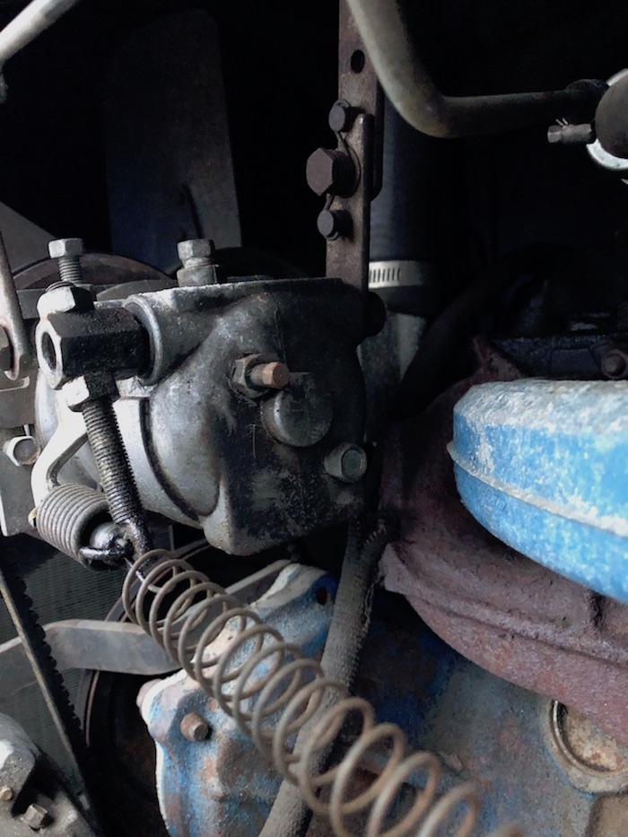

Yes the carb is a bit of an anomaly, and is on our list of things to replace or rebuild soon as it is suspected to be leaking a bit causing the engine to run on after being shut off. If there is a better choice of carb we would certainly be willing to acquire one, even to have as a spare. We are slowly acquiring replacement parts to have on hand if/when problems arise to minimize down time during repairs. Any direction for where to look for hard to find parts would be great.

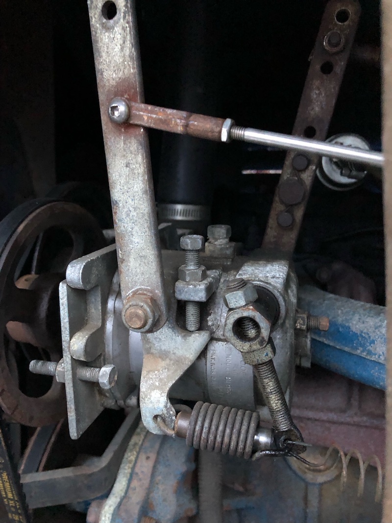

Looks like the Carb is a Holley 1920 rotated 90⁰ from the typical passenger car orientation, possibly to be used with the governor assembly.
The engine also has the factory lifting bracket attached! :D :D
Good luck with your machine.

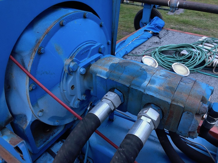

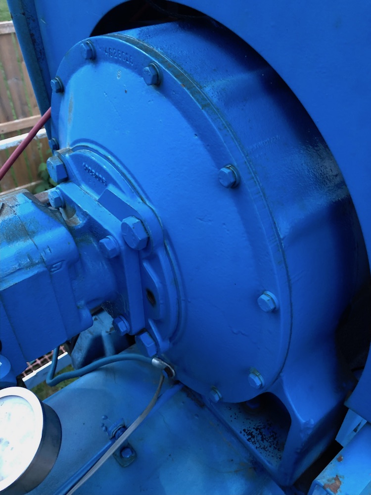

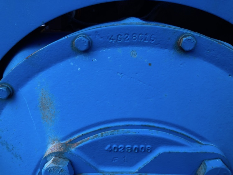

here are some pics of the bellhousing and the reduction/adapter plates for the hydraulic pumps. The numbers stamped into them are 4G28016 (above) and 4038006 (lower), and below that is AF 1. Please disregard the apparent oil leak on top of the pumps, we just had the hoses changed.

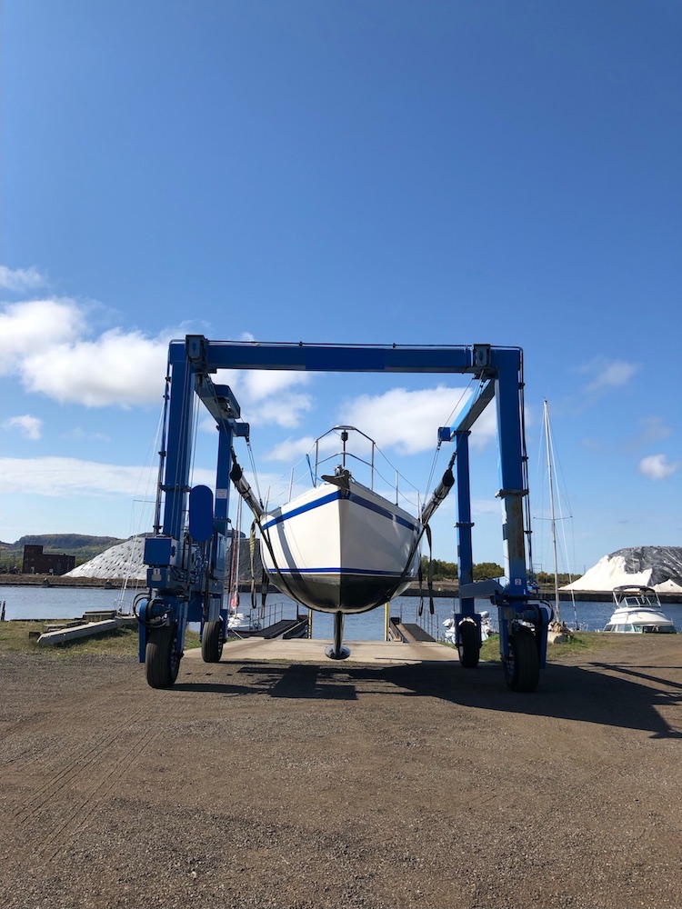

Also including a pic of the machine in case you are interested to see what it does.

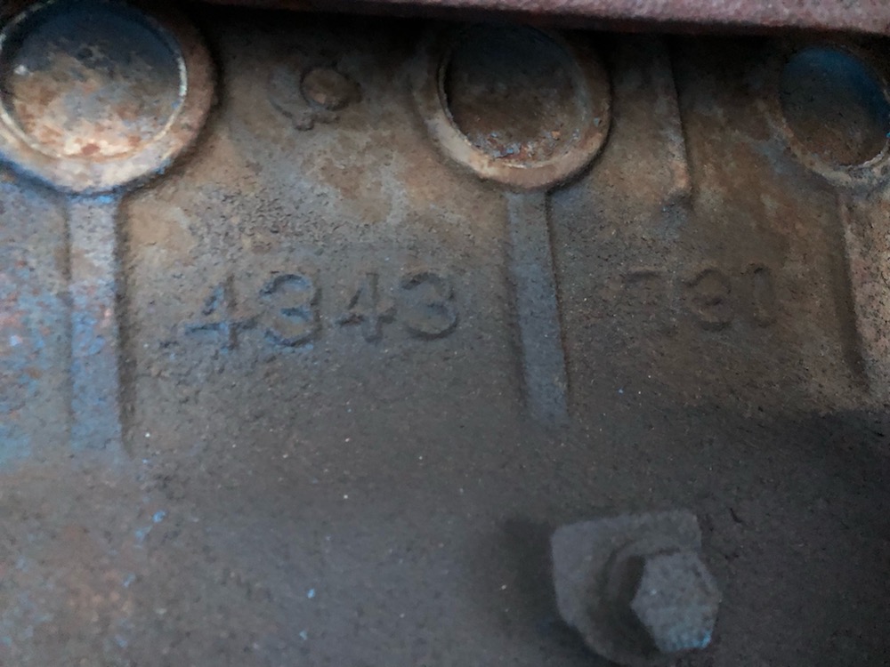

Here are a couple of closer pics of the carb, and one of the number on the left side of the block, 4343 730.
I guess it might help to say that although the ideal would be to find a running engine in good condition, ready to just swap in, I realize that may not be easy to come by. I'm prepared to do a full rebuild if necessary, but the aim is a direct bolt up without getting into adapter plates, moving engine mounts, etc. Shipping a decent engine from anywhere in the US or Canada is definitely an option. I bring in parts for this machine from all over so it's just what has to be done.

In your "reduction" reference I'll assume you're referring to size of the mount, rather than speed of the pumps, as 1800's the industry standard. As those're deadhead pumps, that leaves me wondering what's in that deep a bell housing besides the flywheel.
To that end; would you be kind enough to describe your operating procedure for a lift?

Reduction plates... yes, I meant the step down sizes for the mount, not gear reduction. I agree, there's some magic going on inside that bellhousing but I don't know exactly what. One day we'll open it up and find out I guess but for now it runs fine so not concerned.
