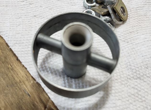

Rick, do your Venturi look like this?
It's a wonder it started and ran at all!
PostPosted: Fri Nov 04, 2022 4:55 pm
Posts: 9349
Yes they do!
My car does pop into the exhaust a little especially when it is cold.I figured that is the nature of the beast with a huge cam and 11.5 to one engine. Not nearly as noticeable when warmed up and not at all with the exhaust on it.
