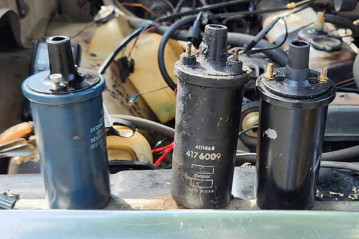

Figured out the issue, I should've checked this from the start but it's been a minute since I've worked on one of these trucks. The ballast resistor is bypassed, overvolting the coil. I couldn't find the bypass so I just added another ballast in line. However I also discovered that neither the new coil I had on the truck nor the one that came on the truck would run on 7 volts, at all, they'd start fine on 12 but not run on 7. I took an old Mopar ignition coil off the 318 I have set aside for this truck, part #4176009 / 411468, it runs happily on 7 volts with an inline ballast resistor, so that's my solution for now.
This has not been fun, but it has taught me I need to remember the basics and check things like voltage, all the old cars / trucks I've owned and this is what got me.
