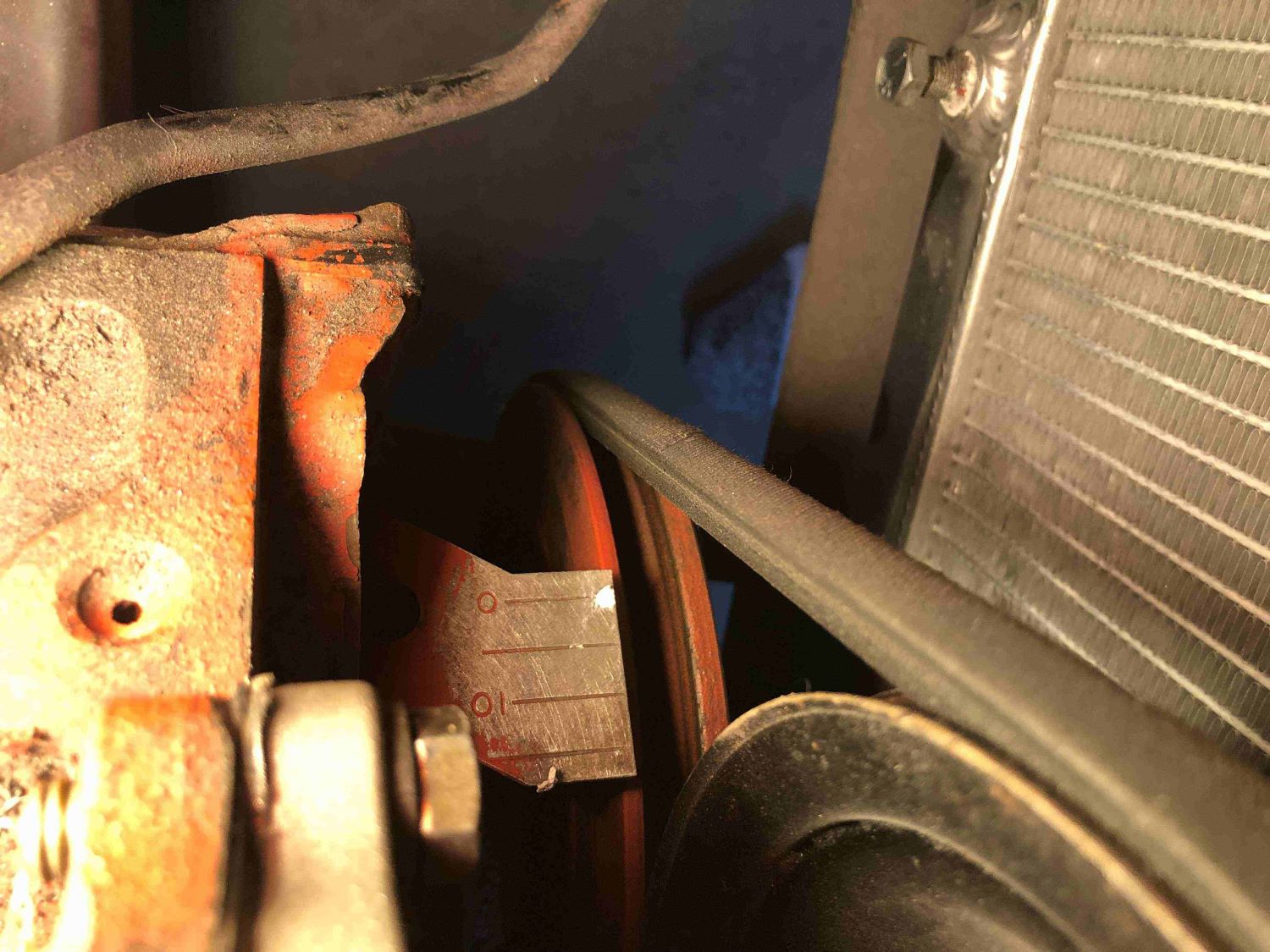

Dumb question, but where is -2.5 degrees BTC on this damper? I've marked the "0" line but need to set to factory specs. I'm assuming BTC has to be to the left of that line
for BTC; ??

2.5 degrees ATDC would be at the bottom edge of that; the numbers are positive degrees BTDC.

I'm not used to looking at the driver's side mount timing tab, but 2.5 degrees BTDC would be half way up between the 0 TDC and the first line up (5 deg mark). Not?

Thats what I thought as well; I need -2.5 degrees BTDC... NOT ATDC

I read your request as negative 2.5 degrees BTDC, hence positive 2.5 ATDC, sorry.
