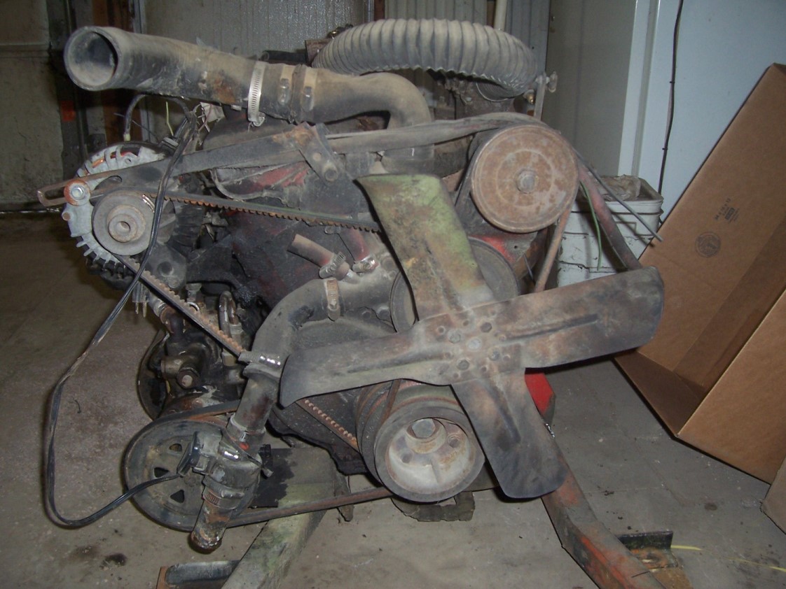

Slant six pictures. Here are a couple of pictures of the /6 these were taken when I first got it in the shop and a picture of my home built log cutting machine. My intentions are to replace the Stihl chainsaw I currently have on the cutter with the slant six mounted ahead of the axle with a drive shaft back to the new Harvester saw that I'm building with chain drive from the drive shaft to the saw. This will give me much more power, heavy .404 pitch chain and a longer bar so I can cut larger diameter or more logs at a time much faster. If you want to see details of how I built the machine you can check my thread on the Outdoor Power Equipment forum at Log cutting machine under Tree Work Equipment by Dave Sr. Thanks for the replies guys I'll probably have more questions after I decide how much of a rebuild I'm going to do on the /6.

PostPosted: Thu Aug 10, 2023 7:07 am
Posts: 17641
Looks like a 64-ish/era engine to me.

PostPosted: Thu Aug 10, 2023 2:23 pm
Posts: 25073
'66-'67 to my eye, judging by the valve cover (min year '66) and the 3 freeze plugs (max year '67).
