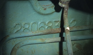

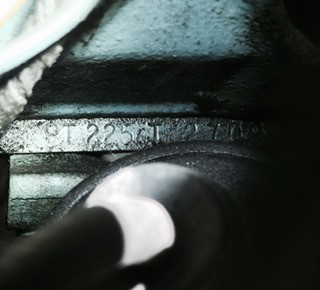

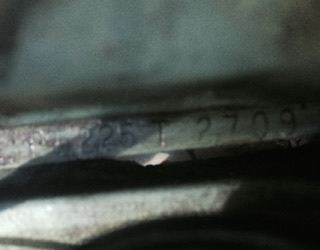

Can anyone help decode these stamps? I thought the motor was replaced in my 69 cuda when I first researched matching the numbers on it - but now I think I might have decided the numbers incorrectly.
The block says 2806830 225 - which based on the above seems like the right year
The small stamp on the side of the motor says PT 225 T 2709. I can’t figure that one out based on the above. Unless I’m looking in the wrong place.
