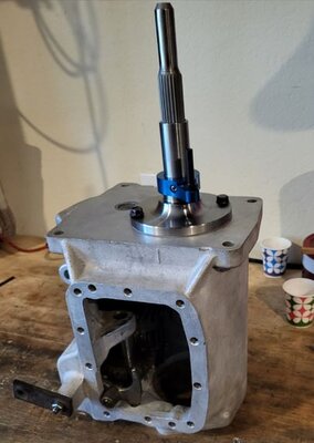

I don't even remember when I started down this new trans project path.
It's been a long time.
But, I just decided to use my old Direct Connection tailshaft housing and get the transmission together.
It was a challenge, like building an overdrive box you have to drop the cluster down in the bottom of the case.
The dogs on 3rd gear hit the cluster and it won't go in.
Makes it a lot harder to get it put back together.
I did learn a new trick after sweating a few hours.
I took the cluster out and used gasket tack to hold the 2 brass shims to the case.
Then put the cluster back in, the main shaft and gears then pull the cluster up into place.
Gluing the shims in place makes it a LOT easier.
Not easy, but easier.
So the "slantzilla-killa" is going back together.

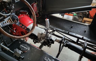

Posts: 2637
Only an idiot would pay what that dang thing cost.
Pretty don't make it fast.
Going to see soon.
